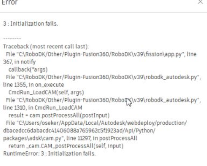

Fusion RoboDK Add-in Error
Our Company has Fusion and RoboDK License.
Fusion 360 Version is up to date(Fusion 360 2.0.16490).
We downloaded RoboDK Addon in Fusion 360.
And then we tried Load Cam Project in RoboDK from Fusion 360.
But we take an error every time.
We ask about that error to RoboDK Support.
They replied like that :
Then, I reinstalled Fusion, reinstalled RoboDK and RoboDK addon.
When I tried again i got error again.
How can we fix that error ?
Could you help me ?
Thanks.
Attached Files Image(s)
You should follow the manual install procedure available here:
https://robodk.com/doc/en/Plugin-Fusion3...ualInstall
Make sure to take the RoboDK addin for Autodesk Fusion from this path:
C:\RoboDK\Other\Plugin-Fusion360\RoboDK\
And not the official Autodesk Fusion website.
I look at the manual when i download this addon.
I tried manual and automatic. It doesnt matter. Still I got that error.
What error do you see?
I saw that errror
Do you have access to CAM features of Autodesk Fusion 360?
Can you generate an APT or G-code file without using the RoboDK add-in?
Can you import curves using the RoboDK add-in for Fusion?
Yes, I hav access to CAM features of Autodesk Fusion 360.
I can generate G-Code file and i can send.
I dont understand last question.
I meant to ask if the other features of the RoboDK Add-in for Fusion work, such as selecting points or curves.
It is better if you can contact us by email, mention this thread and suggest a few times early next week so we can solve this issue faster:
https://robodk.com/contact
