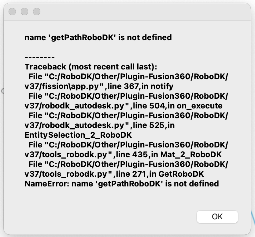

I have some issues with the roboDK plugin for Fusion 360. I used it before without problems, but after an update it doesn't work anymore.
It is running on a mac and get the errors which are visible in the following image:
I guess it has something to do with the references to C:.... which is not present on a mac.
Looking forward to your reply and thanks in advance.
Gertjan.
Hi Gertjan,
Can you reproduce this issue with the latest version of the RoboDK add in for Mac?
I recommend you to follow the steps described here:
https://robodk.com/doc/en/Plugin-Fusion3...ualInstall
Make sure to download the ZIP folder from our website.
Hi Albert,
Thanks for the fast response, I did what you asked.
I used another location before since the path given in the guide doesn't exist on a Mac and this worked.
Now I used the same location for the plugin files and it doesn't work anymore after the updates.
I have it running correctly on one mac but the same trick doesn't work on another one. (due to the updated versions I think)
Do you want me to check something else?
Gertjan.
