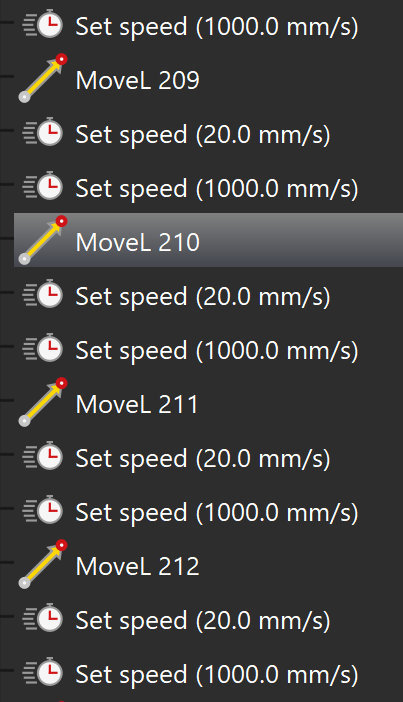

Hi, I have the same problem. Fast move speed from the project settings applied only for the line with G0 and following commands with feed rate from previous G1 commands. I tried to set G0 for every line, but the result isn't perfect and speed applied twice for every move.
This is my g-code and in the attachments you can find screenshot of the generated program.
G1 Z-17. F1200.
G0 Z5.
G0 Z10.068
G0 Y255.
G0 Z5.
