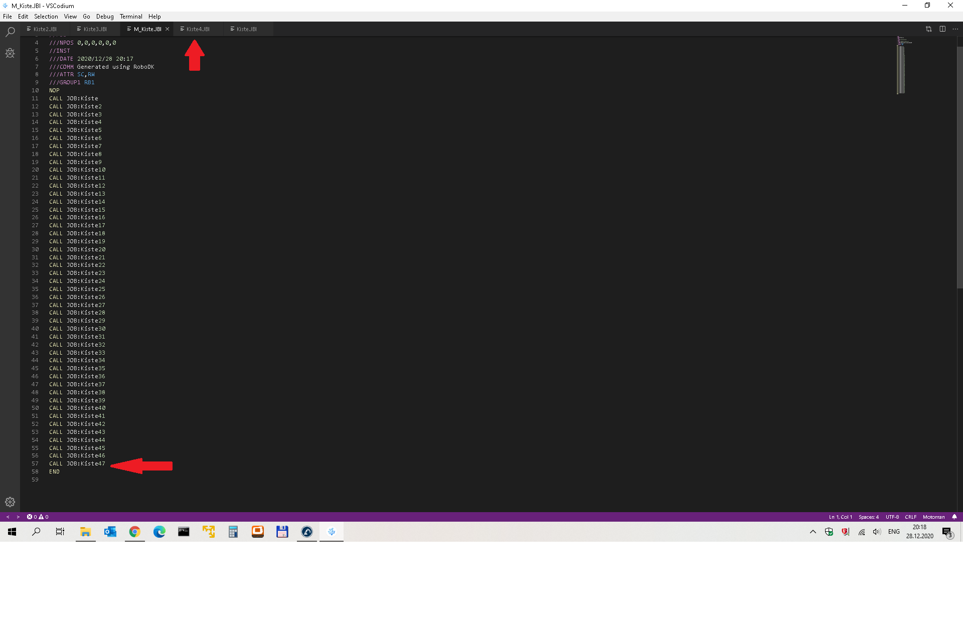

I need please your help with the following issue :
when I finish the adjustment of the simulation and try to generate a robot program, I become one Main Program called the subprograms.
the Main program has 47 subprograms but the simulator gives me only 4 of them. how can I solve that problem?
Please see the Photo!
Hi Othman,
Go to "Tools"->"Options"->"Program" and look for the "Robot folder path:" where all the other programs are saved.
Could also be a good idea to look around at the other options as they can all come in handy at some point.
Thank you!:-)
