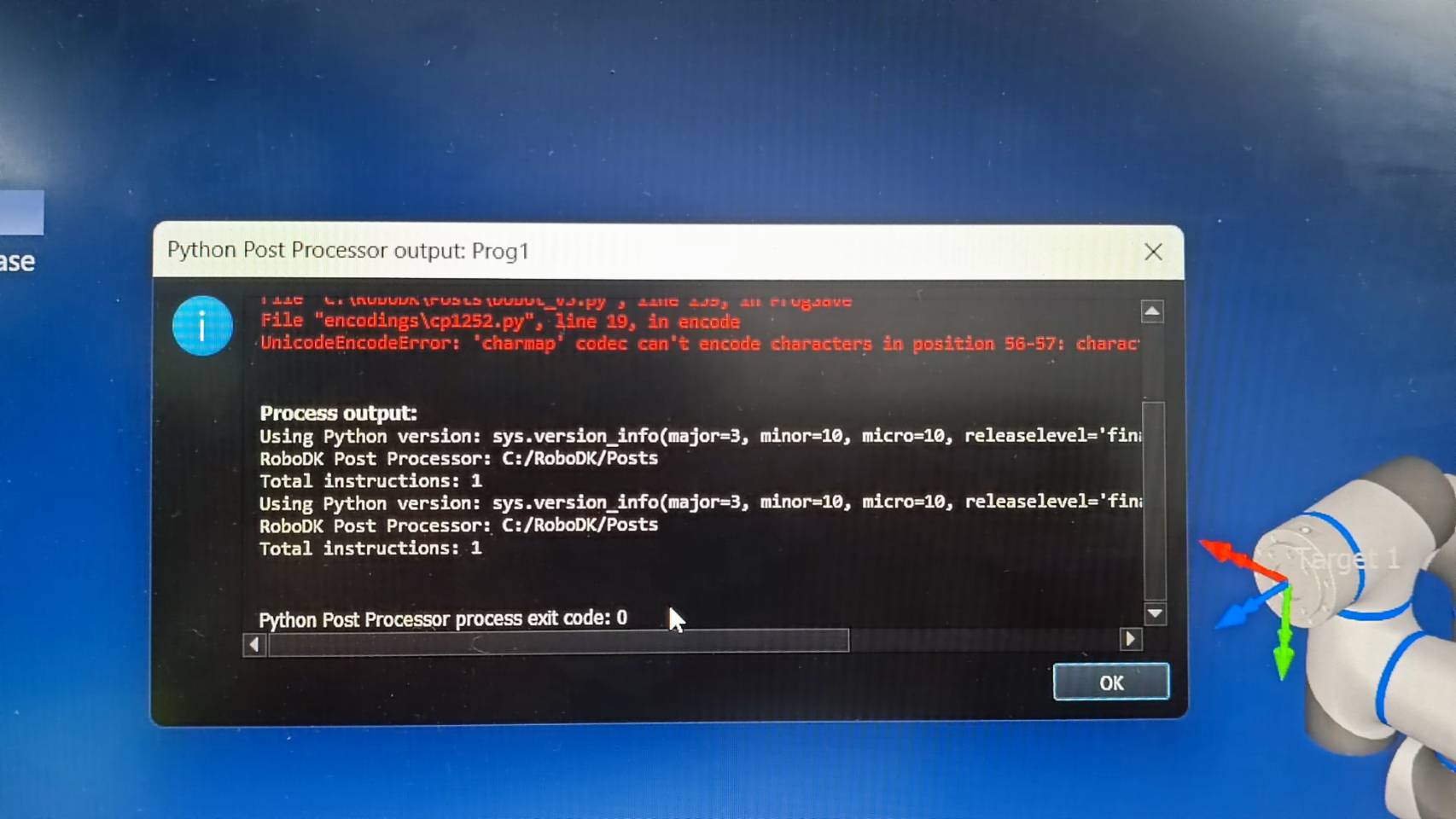

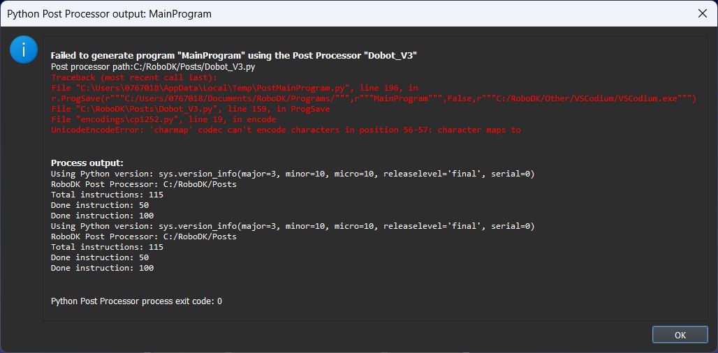

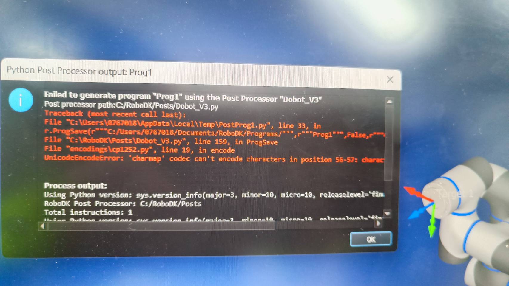

Generate program Error for Dobot robots
205576_0.jpg    205577_0.jpg      dobot,UR Generate Program Error but ABB Fanuc works
Probably you can try using only Latin/English characters for the program name.
Could you please share your station?
We will try to reproduce this error.

I'm unable to reproduce this issue.
Can you try with the latest version of RoboDK?
(11-17-2024, 08:13 AM)Albert Wrote: I'm unable to reproduce this issue.
It's lastest version.
Are you using the default settings? Or do you know what settings you changed from Tools-Options?
If not, can you try using the default settings? You can revert to default settings by selecting: Tools-Options-Set default settings.
