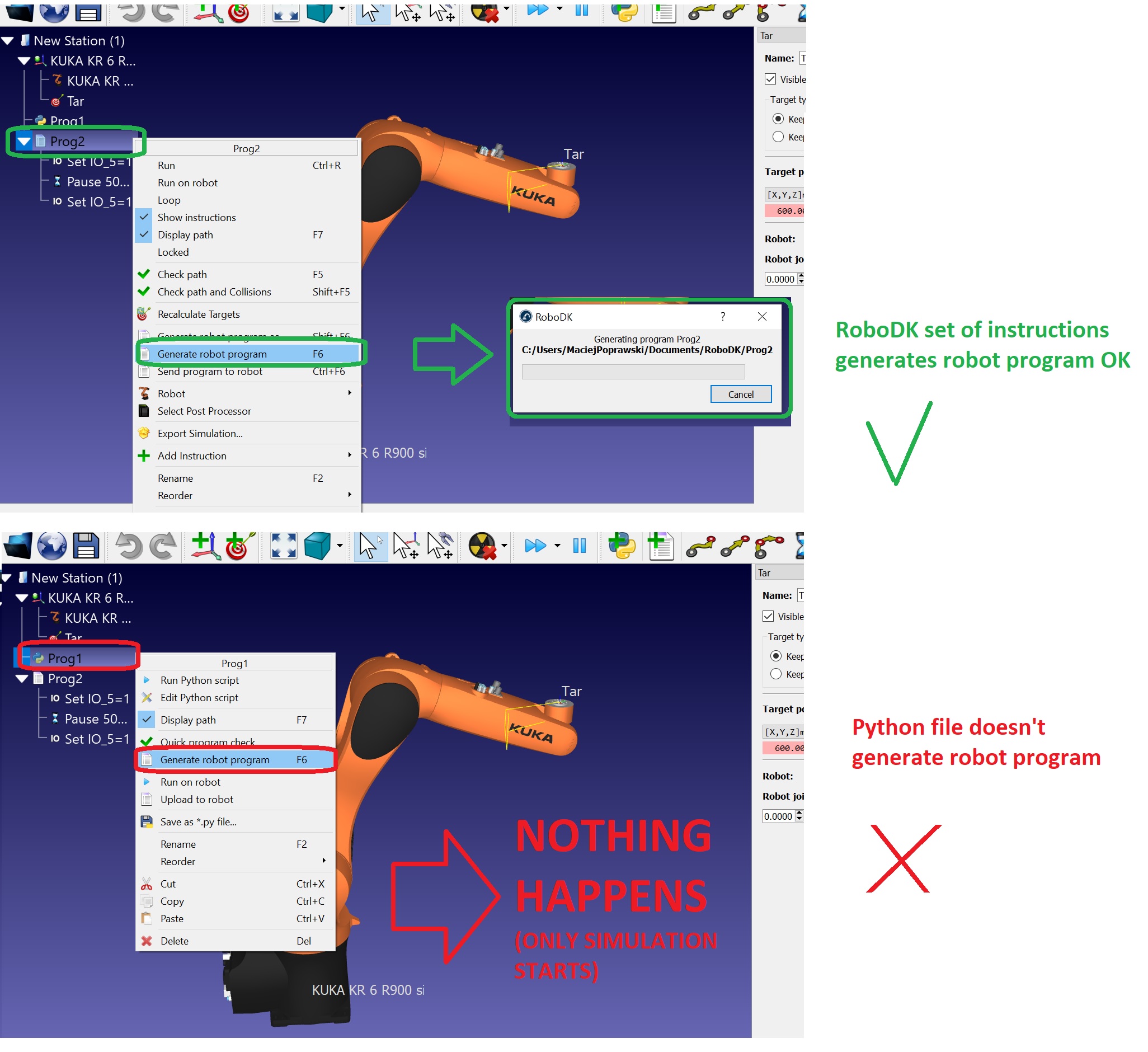

When I right-click on python file to "Generate Robot Program (F6)" it doesn't do anything (creation of SRC file would be expected). It starts the simulation, which runs properly but doesn't save any output file. To make sure it is not a post-processor issue, I created another program in the same station, this time as set of RoboDK instructions - that one always generates src output properly.
Attached is picture to clarify the issue and rdk file. I'm using the latest version of the software.
.rdk   New Station (1).rdk (Size: 320.9 KB / Downloads: 962)

One thing I observed:
I deleted RDK Prog2 so only had python Prog1 in the station.
When I right-click to "Generate Robot Program" only simulation starts and the bottom left corner reads "Running python script..."
When I click F6, however, the bottom left corner reads: "No available programs to generate." and simulations/script doesn't start.

F6 will only generate robot program of a Program in RoboDK and not a script. I have noted it down and will forward this to our Dev guys to see if this needs to be changed or not.
You should try to remove most of your code in your Python script and try generating the robot program again. Make sure you have the robot.MoveJ instruction in your script. There is some part in your script which is not running properly on your system.
