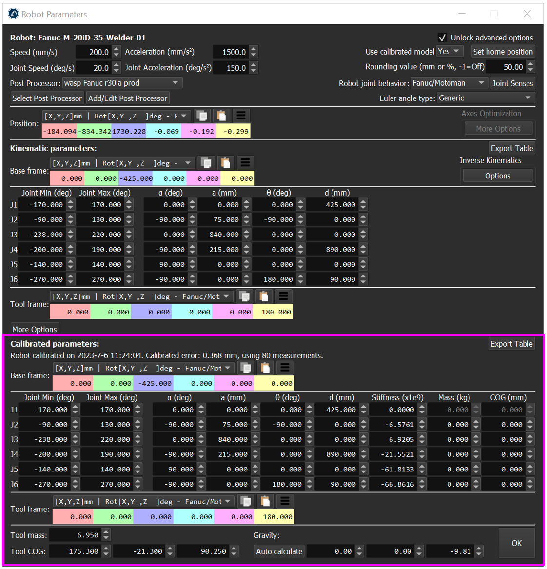

Is there a way to access and update calibrated robot data (boxed in pink below) via the Python API? I tried using
robot.setParam(param="SaveTableCalib", value=path)
where path is a path to a csv file on my repo, but nothing happened.
