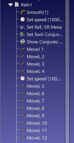

Well, I want to sand a piece, I have 3D model of piece and I am using 'curve tracking'. I connect without problems with my UR 10e, I can run the program but robot stops on every point so I want to up 'blend radius' using Smooth function. By default, his value is 1mm, I can see it clicking on 'Show instructions' and generating robot program:
How you can see Smooth function configure 'blend_radius_m' and it is used by 'movel' commands. However, if I change value of Smooth function to 20mm, for example, and I generate robot program, 'movel' commands is not using 'blend_radius_m' paramater but it sets a default value (16mm).

.How you can see Smooth function configure 'blend_radius_m' and it is used by 'movel' commands. However, if I change value of Smooth function to 20mm, for example, and I generate robot program, 'movel' commands is not using 'blend_radius_m' paramater but it sets a default value (16mm).
