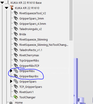

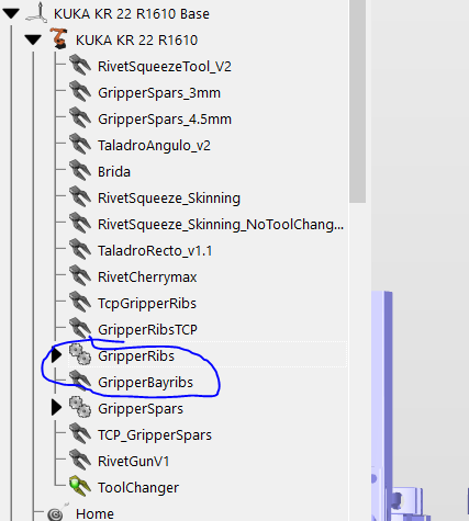

I need to program a tool changer and need to hide the tool on stand and show the tool on robot when the robot picks a tool.
But the event for hiding objects/tools only allows that. My tool is a mechanism and it is not allowed to hide/show by this event instruction.
How can I hide/show a mechanism by an instruction?
Or how can I convert a mechanism to a tool?
As for now I had to work like the attached image looks.
