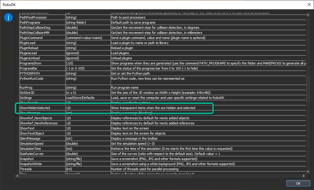

When I deselect "Show object frame" it still shows a translucent frame when the object is selected - how can I prevent the frame from showing even when the object is selected? I'm using the API so if this could be set through that it'd be ideal.

"Tools"->"Run script"->"Show commands"
worked perfect thanks Jeremy
