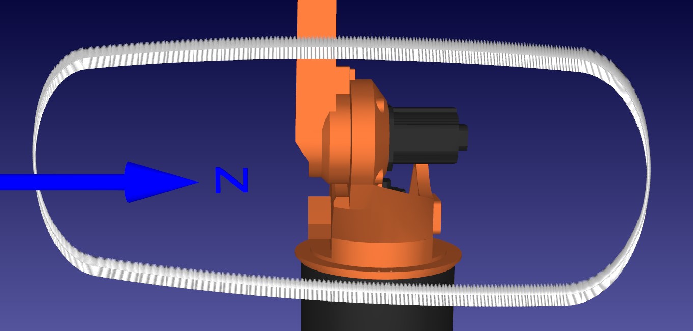

Helllo,
I created a 3D path with igs file,but the arrow direction are all +Z.And because of too many points,I can't select the point I want.
How can I make all arrows normal to the path and toward outside?
You need a surface in contact with your curve so RoboDK can automatically extract the normal to the surface when loading the IGES file.
