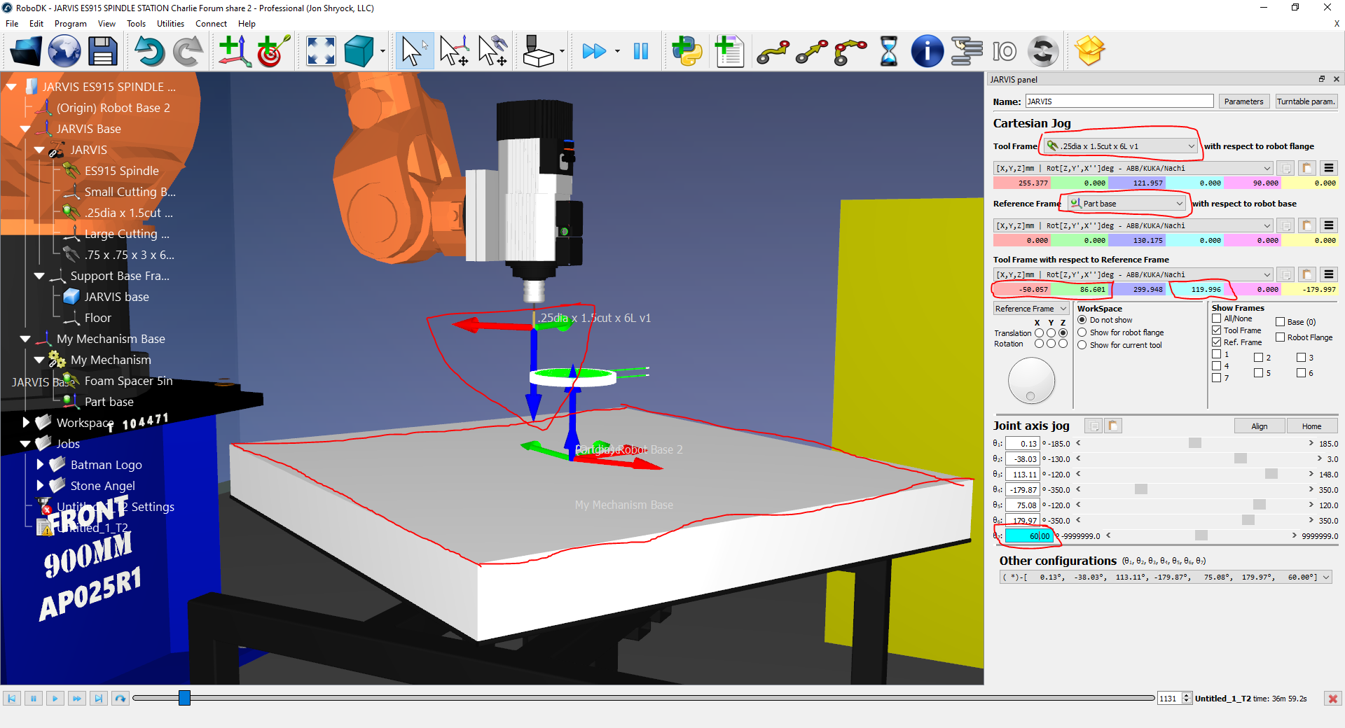

After finally getting a simple toolpath to work from Fusion360 to RoboDK using the plugins, the rotation of the turntable is forcing a rotation of the spindle. Changing the reference from "Part Base" which is bound to the synchronized mechanism flange, to "(Origin) Robot Base 2" which is in the same position as "Part Base," but not bound to the mechanism flange (it doesn't rotate with turntable) does not seem to help.
Putting "Allow a tool Z rotation of +/- (0) gives me the error that the robot cannot reach all targets.
Selecting minimum tool orientation change and teaching the robot position does not resolve it.
Selecting "Move External Axis" or "Prioritize External Axis" did not resolve it.
When I had a "working" program (got a green check mark, but the robot was rotating the head around and crashing through the table and part), I clicked "Keep pos." to try and lock the head down close to the robot. Got the red X [The Robot cannot reach all targets in the path], then unclicked "keep pos." and now even the "working" program I just had is giving me the same red X cannot reach targets error. All I did was check, then uncheck keep pos. What else does it think changed?
All I am trying to do is position the head on the -Y side of the part at a 90deg angle, and allow the turntable to rotate around so the spindle only needs to raise and lower in Robot Base ref Z.
*Update*
I made an example reference to try and better communicate the problem. I hit my limit of posts today, and can only attach 7 items.
Attached you will see the Cartesian coordinates change in the X, Y, and A,  with just the rotation of the turntable. It behaves like my reference frame with respect to robot base is the turntable flange. It would make sense if that were the case. But no matter what I make my reference frame, the turntable flange reference overrides it. This behavior manifests in the program also, causing the toolhead to rotate about in ludicrous directions, causing collisions.
Whatever else you need from me to better communicate this issue, please let me know. I have been tackling this issue for over a month now, with no support. I just want to move forward. We have a professional license, and have paid for 1 year of maintenance. I have called, emailed, and posted in the forum, and utilized the "help>Request Support" option in RoboDK.

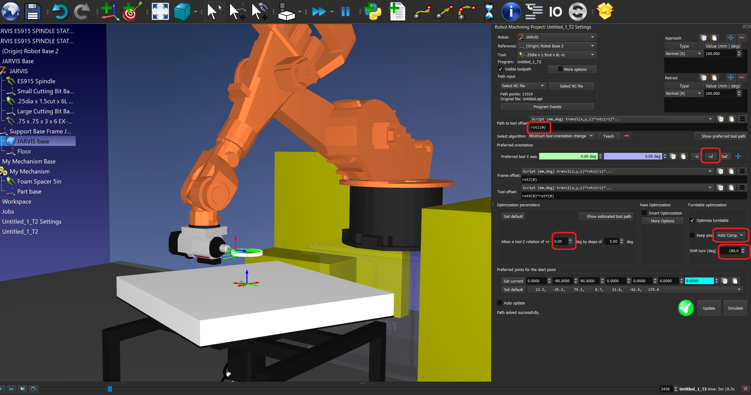

I'm sorry we took so long to get back to you. Sending us an email is best if you own a Professional license.
I believe you are looking for the option "Auto Comp". Activating this option in the Turntable optimization settings prevents the strange rotation around the tool Z axis you see in the projects you shared.
With this option activated, you mainly have to adjust these 2 settings:
  1. Shift turn (inside Turntable optimization, currently 180 deg) allows you to control the angle with respect to the XZ plane of the turntable root frame.
  2. Path to tool offset allows you to control the rotation around the Z axis of the tool. A Z rotation of zero will be vertical up (tool X axis pointing up). Also, selecting the +Z is important and makes the tool behave this way (you already had selected or was probably the default setting with your turntable setup).
See the attached image and your project with my edits.
I recommend you to set the "Allow a tool Z rotation of +/-" to 0 deg and I don't recommend you to use the "Smart Optimization" because it will take longer to calculate. The settings mentioned above should allow you to have full control about how you want to manage the turntable and give you fast results (for example if you are using +1M points).

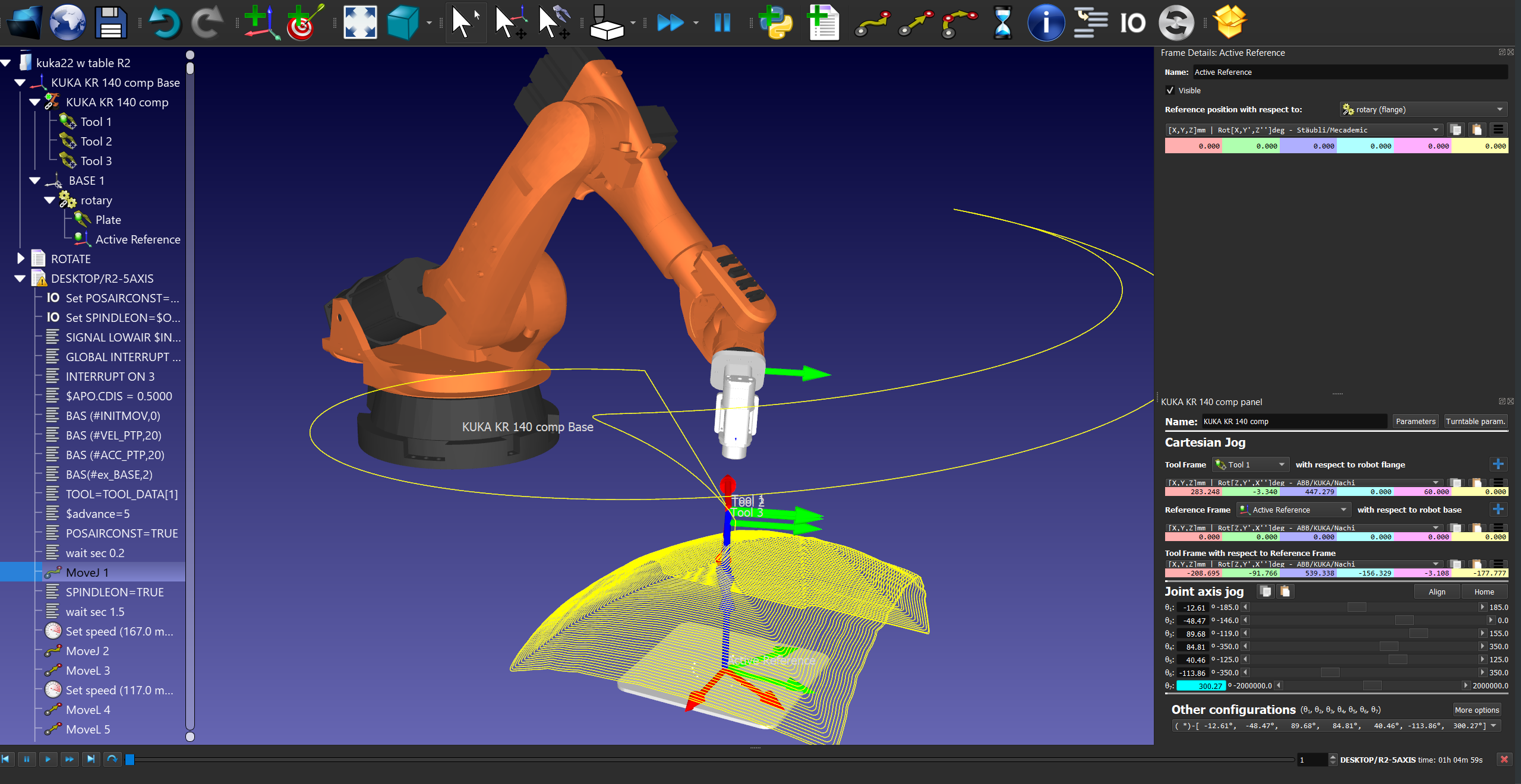

I see a few details about how you built your cell that could be improved:
  1. You should add a coordinate system attached to your turntable and make it the Active Reference. This means it should be selected in your robot panel as the reference. I assumed it is at 0,0,0,0,0,0 location with respect to the root point (XYZABC).
  2. You should extend the joint limits of your turntable (E1, or joint 7 in RoboDK), so it accepts your working joints.
  3. I believe you wanted the rotation of your turntable to be swapped (joint sense was set to -1).
You can then import your SRC file (as pose targets) and you can make sure the movement it does is what you expect.
See attached file and image.
On the other hand, I would recommend you to import machining files as APT file.
.rdk   R2-v2.rdk (Size: 5.5 MB / Downloads: 1,070)

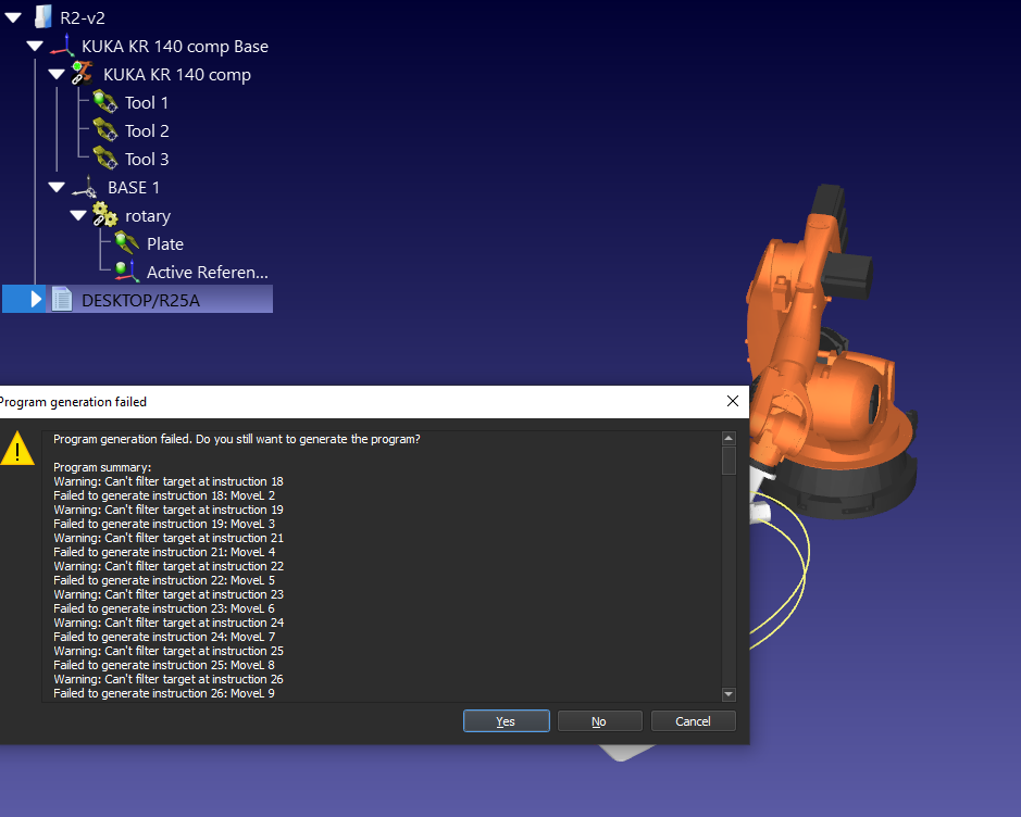

(11-02-2022, 03:17 PM)Albert Wrote: You can then import your SRC file (as pose targets) and you can make sure the movement it does is what you expect.
I'm able to import a SRC file as pose targets and simulate it as-is using the RDK file you attached, but the filtering doesn't work. I get a "can't filter target" on every single line (capture.png)
I can't export a useful APT file from sprutcam, so that doesn't seem to be an option.
Also, in turntable parameters, if I select "use calibrate model" it says the robot is not calibrated - but the green dot is highlighted on the robot and the active reference frame as well. (capture2.png)
not sure why that posted, i had the wrong capture.png file. here is the error message when trying to generate a filtered program.
