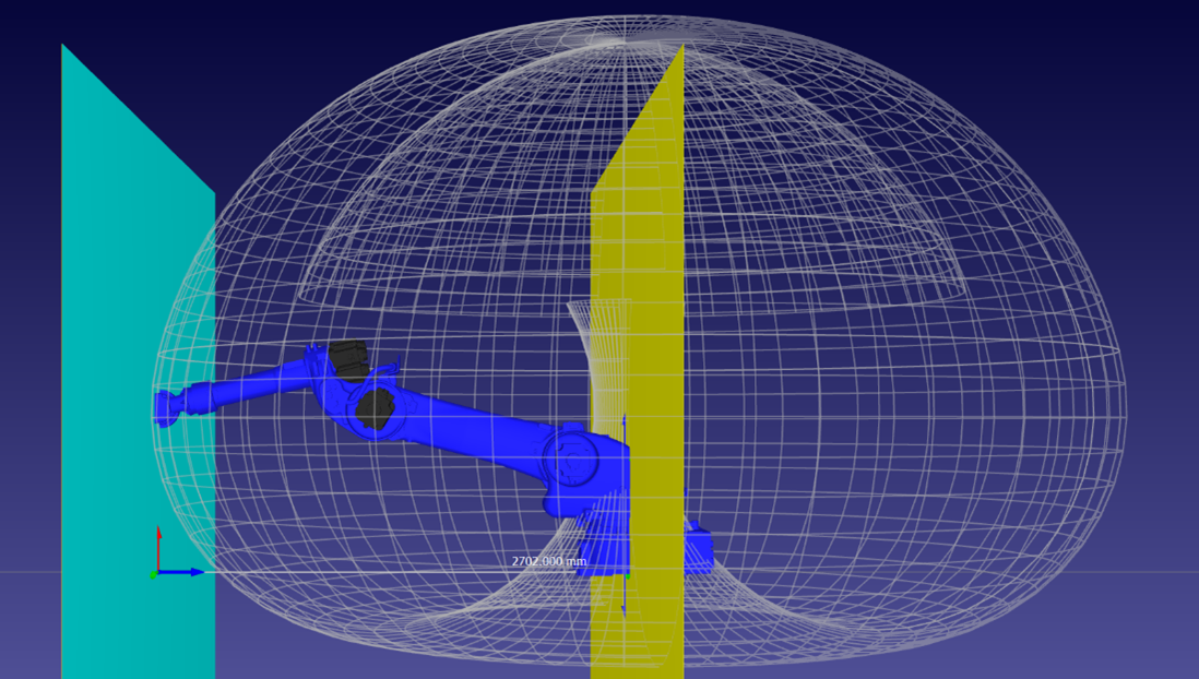

I’m starting to use RoboDK again and I’m struggling with remembering how to create a "plane", I use this to measure the distance like in the image. Does someone know the steps to create this type of "planes" (the ones in blue and yellow).

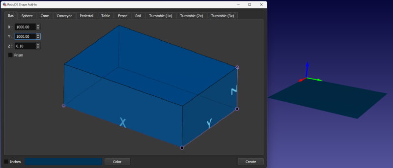

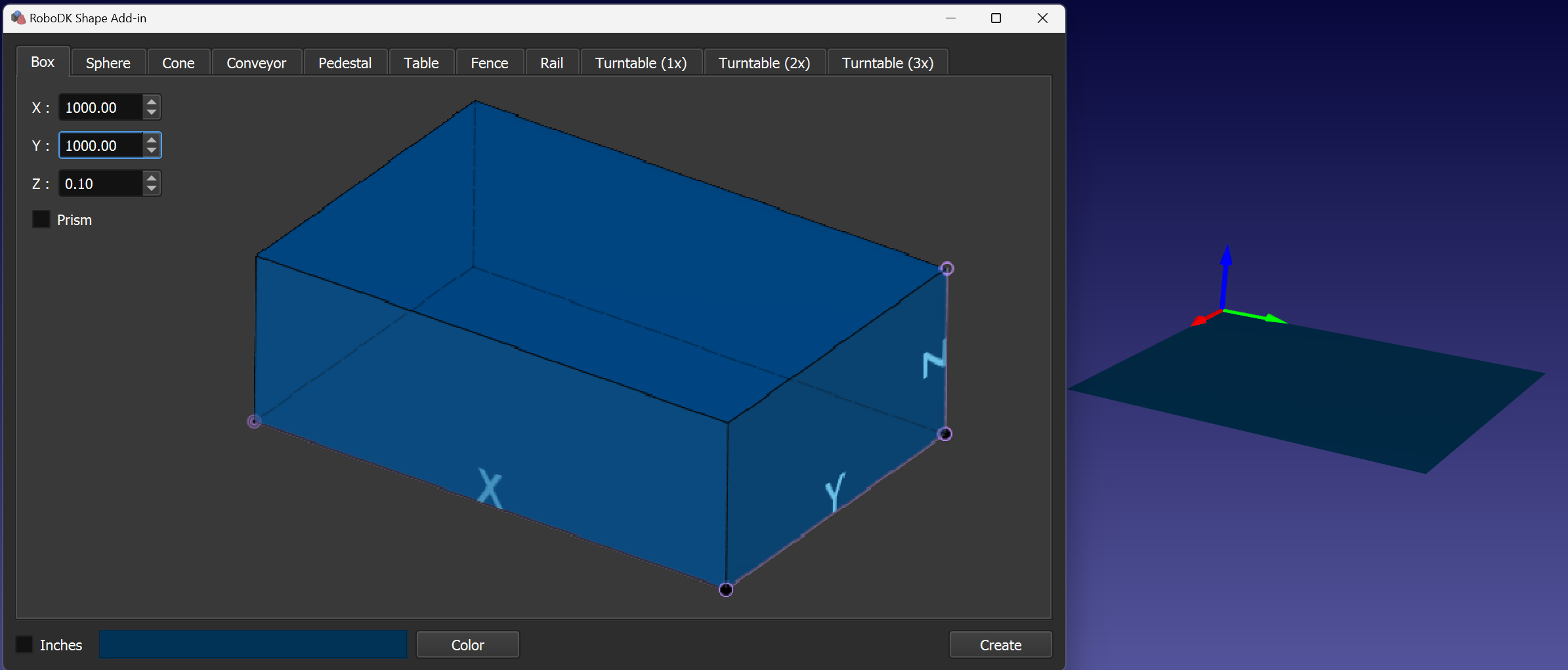

You can create a very thin box with the Shape Add-in.
https://robodk.com/addin/com.robodk.app.shape
