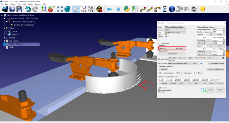

I open sample project as the “Example-03.b-Welding Station - Fanuc.rdk”
Please check the attachment “20200206.png” red arrowthe welding path toolaxis is the curve 45 degreebut I try to select the other curvethe toolaxis is always normal the surface
So my question is how to let the toolaxis modify between these surfaces?

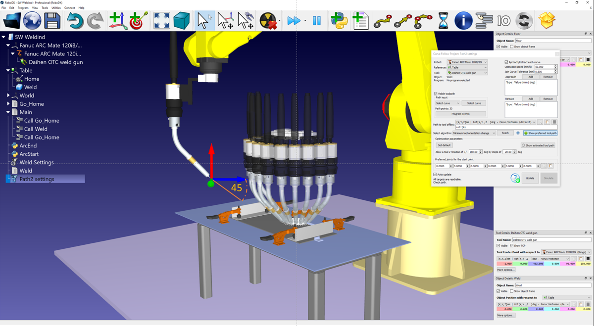

If you want to have a 45-degree angle with the surface, you can simply create a new TCP (Tool Center Point) with the Z axis pointing at a 45 degrees angle with respect to the welder central axis. This way, you can obtain the required angle between the welder and the surface.
You can also right click on an extracted curve and select "Tilt curve normals" and enter and angle. But I would say that this is not a very consistent feature.

For the 45 degree angle, see pictures attached.
That should help.
