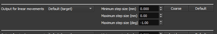

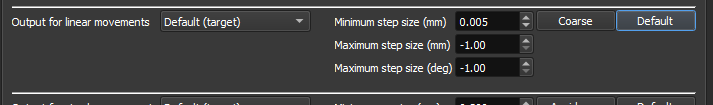

In RoboDK settings there is the option for, "Output for linear movements". Where I can set the values to 0 to prevent the movements from getting filtered. But I would like to avoid setting them to 0 in case I actually have duplicate instructions along the path that may cause the robot to throw errors or do something weird.
