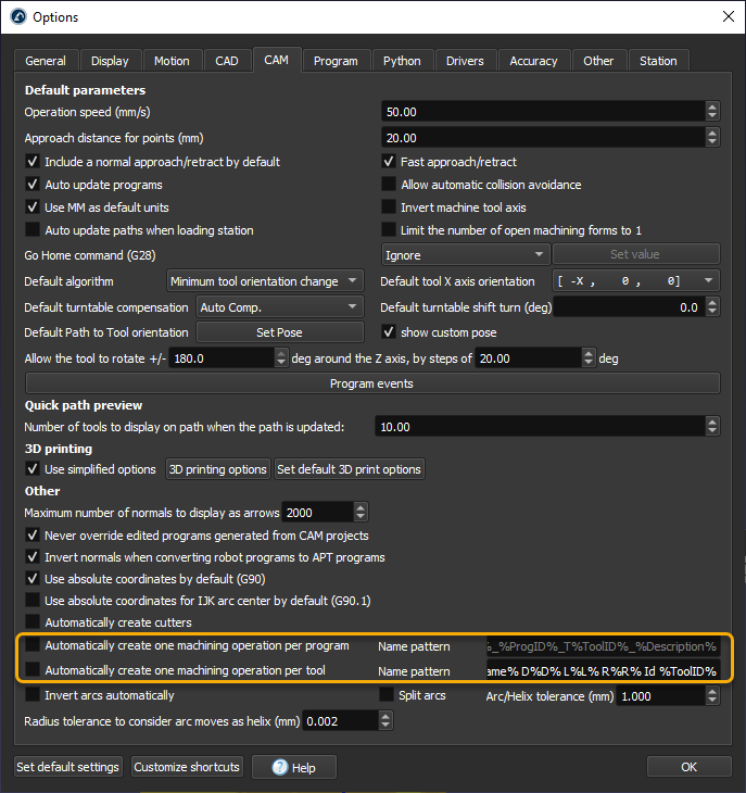

I have designed a machinery project in RhinoCAM and imported it into RoboDK. Can anyone let me know how I can split the design into 4 subprograms in RoboDK, please? I need the robot to do one program, go to the home position, rotate the turntable, do the second program, and so on.
Try activating these options in "Tools"->"Options".
