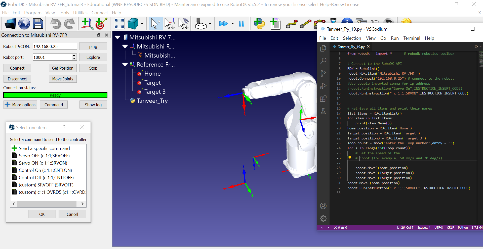

I'm using a Mitsubishi robot controlled via the RoboDK Python API. I am trying to turn on the servo from the python script and after cycle operation I want to turn off the servo. But cannot achieve this. Please find the attached image that contains my script code and the setup. I am also attaching the script code here. Kindly advise on my wrong steps.

You can send custom commands to the driver by using setParam. For example, if you want to turn the servo off of your Mitsubishi robot you can do this:
robot.setParam("Driver", "c 1;1;SRVOFF")
# or
robot.setParam("Driver", "SRVOFF")
Thanks Albert for the reply. I will try it on Monday. By the way, where can I get the RoboDK equivalent for various commands of Mitsubishi or other robots. Because I found that the command syntax to turn off the servo for the said robot is different which is "Servo OFF" not "SRVOFF". "Servo OFF" is according to the Mitsubishi RT toolbox. I am kind of confused regarding this hope you could clarify.
The commands available for each driver are usually displayed in the commands window of the robot connection.
RoboDK can have some predefined commands, such as SRVOFF for Mitsubishi, which will trigger the Mitsubishi code 1;1;SRVOFF. This is the command required by the controller. In short, the "c" letter allows you to pass any supported command by the Mitsubishi robot itself.
