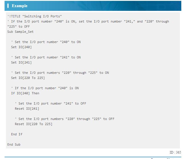

I am trying to control the I/O on my Denso VS-087.  The Set I/O function does not post the right command that the Denso Controller is looking for. Is there a way to write a custom Set IO scrip for my extruder on and off command?   Denso wants to see Set IO[25]  to turn on and Reset IO [25] to turn off.
