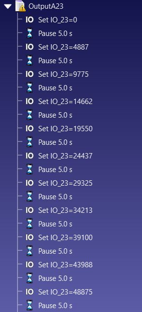

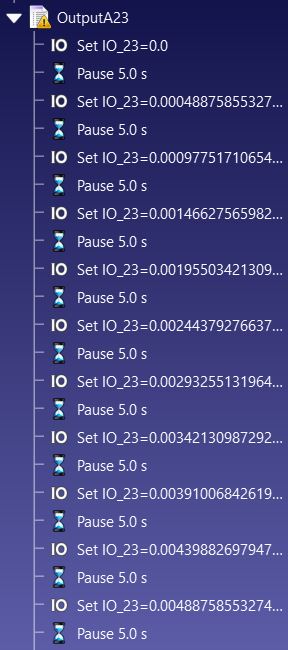

For testing purposes I created a program using the RoboDK GUI and noticed that RoboDK seems to treat the IO-value as an integer. Please see the screenshots attached.
When using decimals I get 0V output voltage for the given examples. As a workaround I multiplied the values by 1,000,000 and transformed them to integers. Inside the robot driver I divide them by 1,000,000 again and everything works fine.
It is not necessarily a bug, more like a suggestion for improvement. It would be comfortable if the IO-instructions would accept decimal values straightforward.
I changed my robot driver according to Albert's suggestion in order to support analog output ->Related Thread
