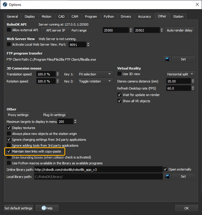

First, make sure that this option is activated:

One thing you might still need to do is "relink" the targets with the robot.
To do so, select the targets -> Right-click -> Robot linked -> Select the right robot.
The same might be needed for the programs.
