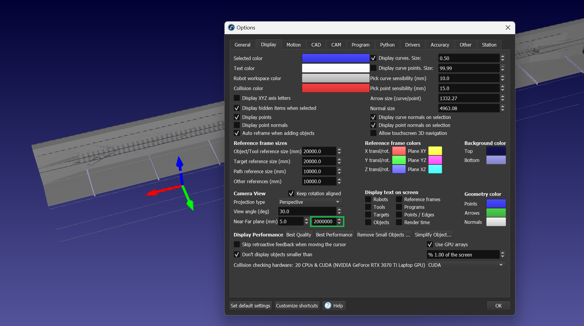

The length of this part is more than 160 meters, it's the reason why you do not see it with the default RoboDK display settings.
You can go to Tools->Options->Display and change the upper bound value for the Near-Far plane of the Camera View.
(04-04-2023, 08:47 AM)Sergei Wrote: The length of this part is more than 160 meters, it's the reason why you do not see it with the default RoboDK display settings.
