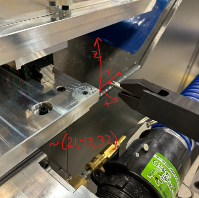

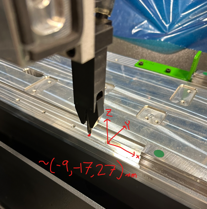

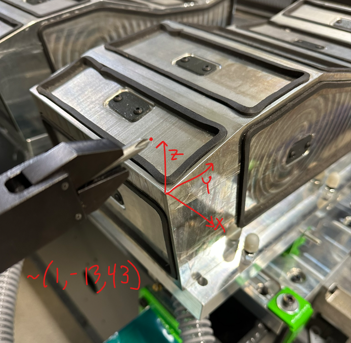

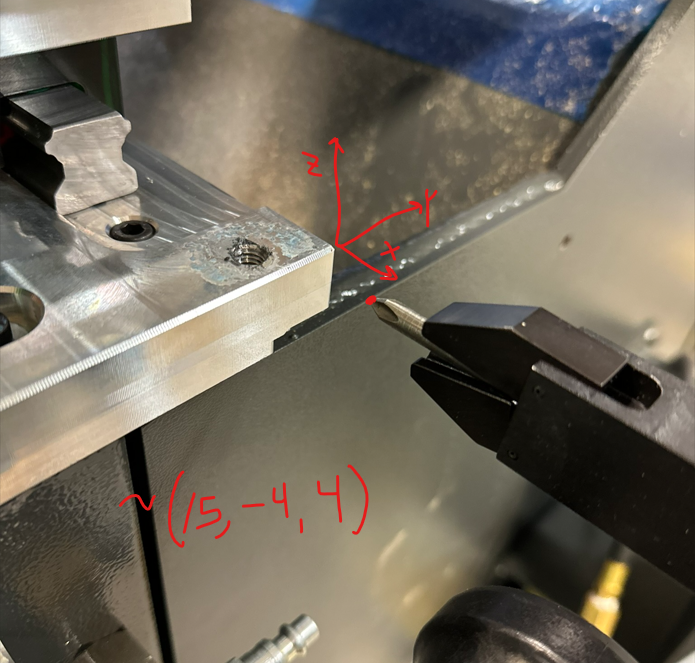

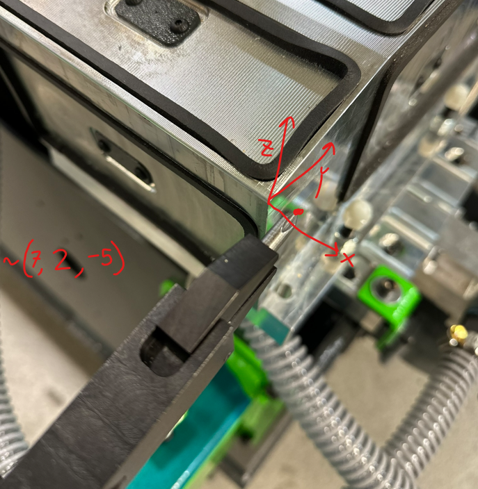

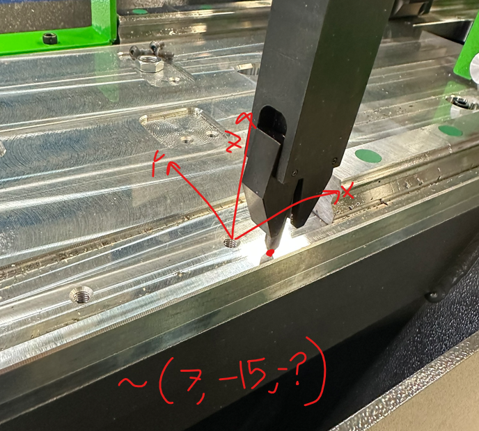

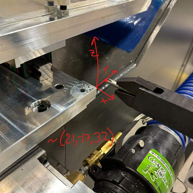

I am currently trying to offline program through RoboDK two identical robot assembly stations. The problem that I am running into is that my robots aren't accurate with what the RoboDK simulation is showing and the robots aren't accurate between each other running the same program. I calibrated my TCP to <1mm accuracy and I know that my cell layout is accurate enough for what I am trying to do. Because this is my first proper attempt at offline programming, I could be missing something more fundamental here.
I have attached my station file (the 'actest' program my accuracy testing program) along with pictures showing where my TCP roughly sits in real life at these points for both robot A and B.
I have also tried running this program with both only J moves and only L moves. Both don't yield accurate results.
As these pictures show, the inaccuracy of the TCP with respect to the targets varies point to point and robot to robot. This leads me to believe this issue has something to do with how the robot joint information on RoboDK differ from the joints on the real robots. Could the robot not being calibrated cause some of these positions to be more than 40mm off?

How do you know your tool (TCP) is accurate within 1 mm? I checked your tool calibration in the RoboDK project you shared and I see you used 4 points on a plane. I recommend you to use more points to get a good understanding of tool errors (10 at least).
Also, how accurate is the robot supposed to be? Make sure the dimensions of your robot arm in RoboDK match the dimenstions in the robot controller.
It looks like you customized your post processor. What did you change? Are you mixing joint movements and cartesian movements?

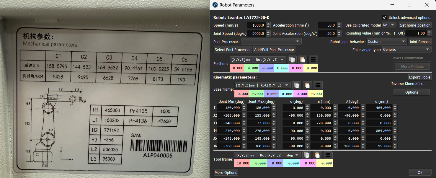

This I didn't do and also am not sure how to. The robot models are pulled from the RoboDK library. Each robot has mechanical parameters and they are called out on a plate in the robot cabinet. (see attached image) Is there some data field in RoboDK where I can put the specific robot parameters called out on this plate?

By checking the mechanical parameters of the robot you shared and comparing against the robot you are using in RoboDK we can see an important mismatch. I assume the values are in microns, and H3 is modeled as 0 mm in the robot in RoboDK. Other values like L1 and H2 and L2 differ by a few mm (1-2 mm). I recommend you to model the robot properly to fix the accuracy issues.
Also, getting a good accuracy of your TCP is not a good indicator if you used only 4 points. You should use more points and calibrate your TCP by a point instead of a plane.
