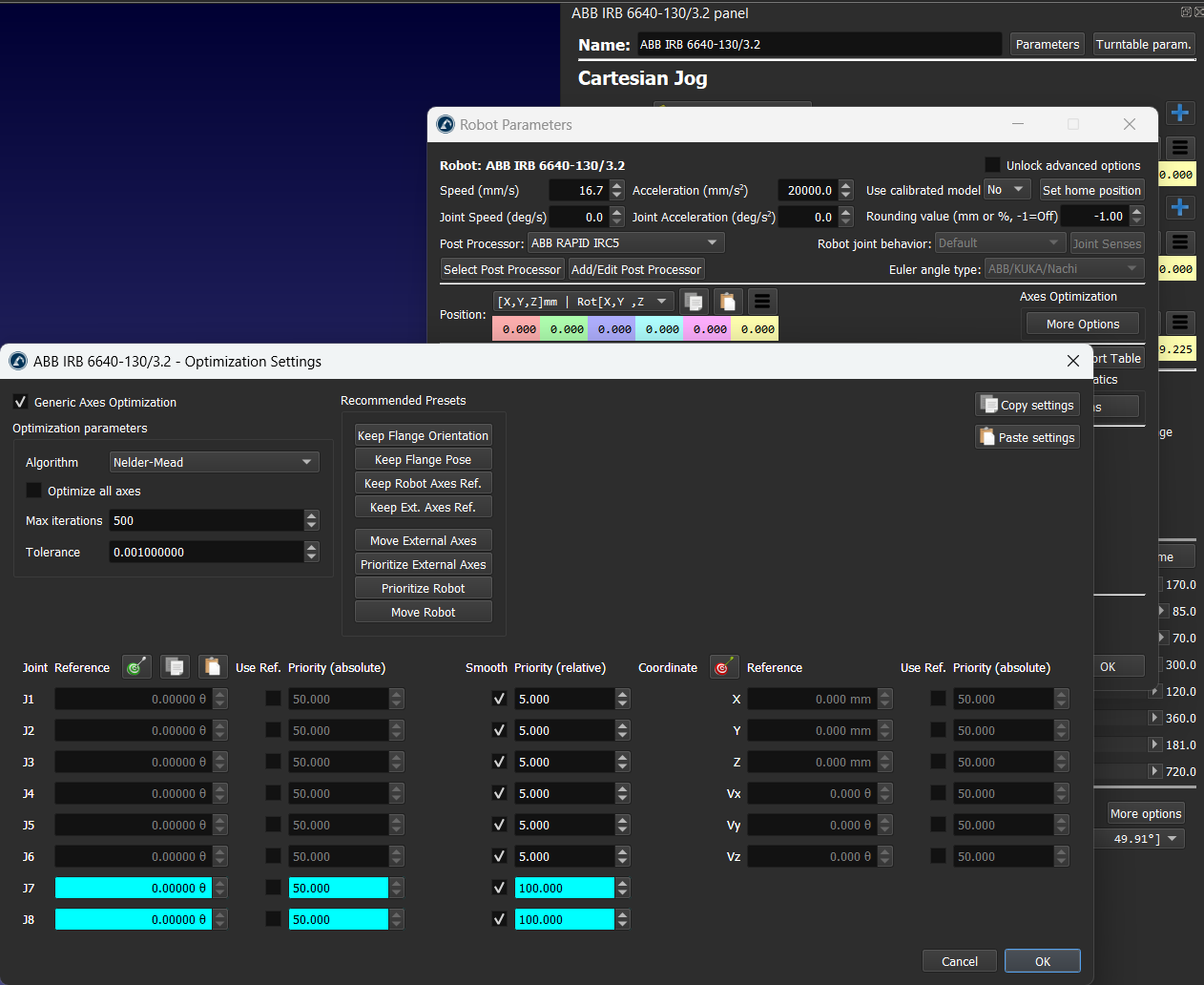

(03-13-2025, 08:09 PM)Albert Wrote: You can still calculate the inverse kinematics with an 8 axis system. You simply need to provide estimate joint values and RoboDK will use the additional axes as the reference. Either I didn’t understand or we are not synced on the issue. I want to set Pose ie translation and orientation , and in turn let roboDK find the appropriate J1-J8 values . At the moment in the trial version there is not iterative ik for more than 6 axis arm although i did synchronized it with 2 linear axis. When I set Pose the current values of the axis doesn’t change. So the roboDK doesn’t solve the ik problem and send a bad location although there is a viable solution including all 8 axis . How can I set Pose and get a solution on all 8 axis ?
You can enable automatic Axes optimization in the robot Parameters menu:
