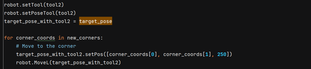

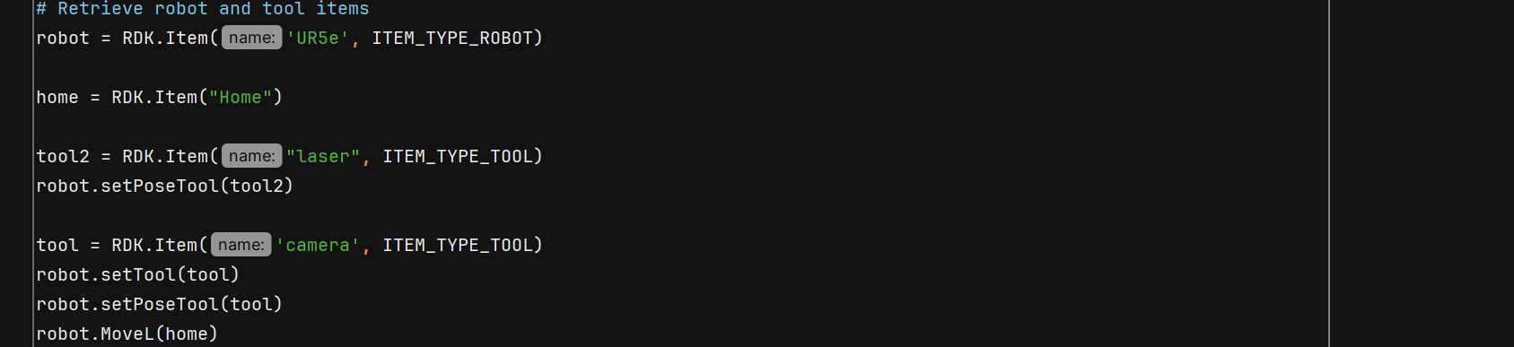

Below are some snippets of the code where I initialize the tools and call them. Could you help me understand why this might be happening and how to fix it?

setTool and setPoseTool are the same command (however, setTool is deprecated)

I was just using setPoseTool(), but I added setTool() just to be sure.

When changing the tool, just providing the tool item with setPoseTool should update the tool linked with the robot and update the tool pose at the same time.
