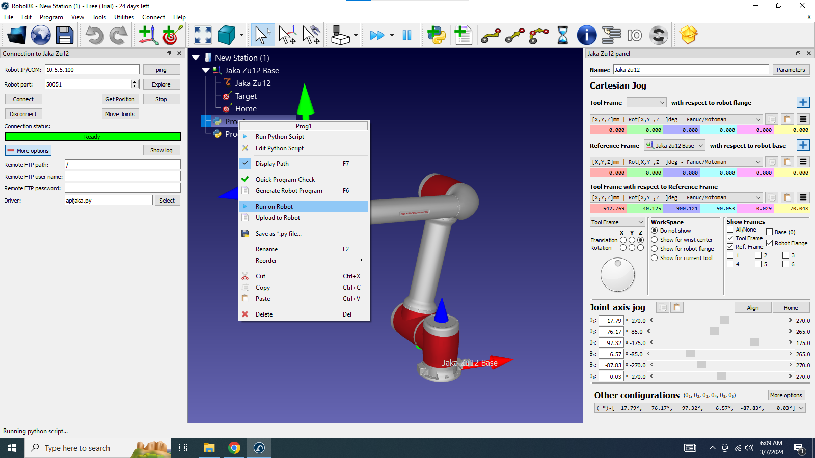

I am experiencing a problem with running a Python script on my Jaka Zu12 robot. The script successfully executed once, but next attempts to run it have failed, even though the robot connects and synchronizes. The robot responds to manual commands through the Move Joint button, Get Position button, and simple(target) programs work fine, but the Python script is not functioning.
The script generates and displays the path in the simulator but it doesn't act on the robot arm.
Below is the script I'm using:# You can also use the new version of the API:

I have also attached a screenshot for reference. Also, a video of it working one time :))

One workaround to force the API commands to be sent to the robot is to do the following:
robot.Connect()
Right before you start any robot movements or robot commands.

Dear Albert,
Thanks for your prompt advice, implementing the robot.Connect() command, resolved the issue perfectly.
In response to your question: "Is the script you attached the same as the one you executed from your RoboDK project?" - Yes, it's the same script.
Additionally, I want to inform you that when dragging and dropping the Jaka-Zu12.robot file the default driver is set as JakaDriver, which fails to connect. Attached screenshot. However, changing it to apijaka.py in the driver settings successfully establishes the connection.
