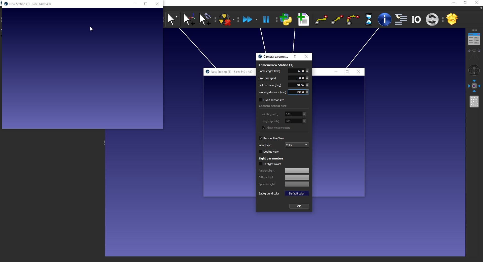

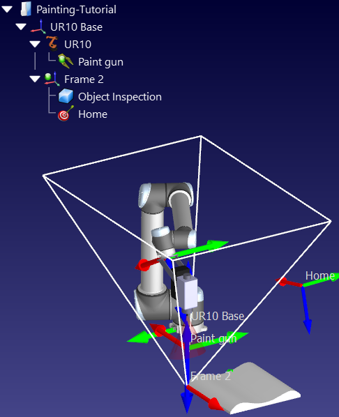

2. Cam2D_Add does not add the Item to the tree
Creating a camera using the API does not behave in the same way as through the Connect - Simulate 2D camera. It is not added to the station tree. See CameraAddTree attachment
3. Settings passed to cam_params does not apply correctly
Using the code above, as per the example of CameraAdd.py, the applied settings differ. See CameraSettings atachment
