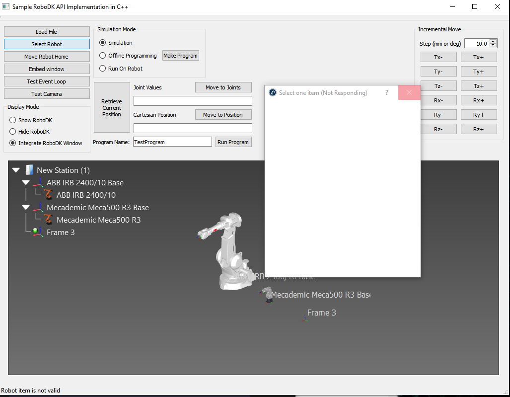

To reproduce using the existing C++ Sample application, simply:
- start the sample
- click on "Integrate RoboDK Window"
- add a first robot in the station, then a second, then a reference frame (like in the attached screenshot)
- click on the "Select Robot" button
The sample is frozen.
I have the same problem with our integration of RodoDK window inside a Qt application.

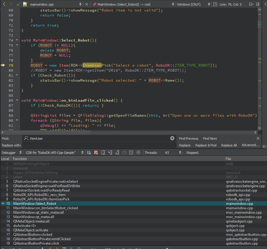

I think this issue is related to RoboDK's main loop being blocked when you use a Qt application. This issue will happen when you use embedded windows with RoboDK and you display a blocking dialog from RoboDK using the API.
