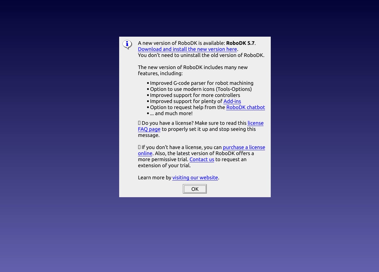

Dear Sir,
Thank you for providing the Jetson version of the RoboDK program for testing. Based on my testing conditions, please find the details below:
Device Used: NVIDIA® Jetson Nano™ 2GB
System Version: JetPack 4.6.1 (official release)
Program Download Location: /home/ubuntu/Downloads
Steps Taken:
Extract the Program: tar -xvzf Install-RoboDK-Jetson.tar.gz
After extraction, the following files appeared: RoboDK/, Install-RoboDK.sh, and Instructions-Install.txt
Set Install-RoboDK.sh as Executable:
Path: /home/ubuntu/Downloads/Install-RoboDK.sh
Right-click → Properties → Permissions → Select "Execute - Anyone" → OK
Run the Installation Script: sudo ./Install-RoboDK.sh
Current Issues:
Question 1: After completing the installation steps, a RoboDK folder was created under /home/ubuntu/. I attempted to run /home/ubuntu/RoboDK/RoboDK-Start.sh, but the program becomes completely unresponsive upon opening with no response whatsoever. Could I have made an error in any of the steps?
Question 2: I noticed another Install-RoboDK.sh file in the RoboDK folder. I tried executing the file located at /home/ubuntu/Downloads/RoboDK/Install-RoboDK.sh, but the program also became unresponsive.
I found on the forum that you successfully tested the version for NVIDIA® Jetson Nano™ 2GB. Could you please provide some assistance or troubleshooting suggestions?
Thank you very much for your help, and I look forward to your reply!
If RoboDK is not responding with your Nvidia Jetson device I recommend you to try running the start script using elevated privileges:
sudo /home/ubuntu/RoboDK/RoboDK-Start.sh
Thank you for your previous assistance! I have tried the permission elevation method you suggested and ensured that all dependencies are installed. Additionally, I followed the installation process precisely according to the manual, but I am still unable to launch the program successfully.
Do you have any other suggestions or methods that might help resolve this issue? If possible, could you also perform another test on the NVIDIA® Jetson Nano™ 2GB to confirm the source of the problem?
Thank you very much for your help, and I look forward to receiving further guidance!
