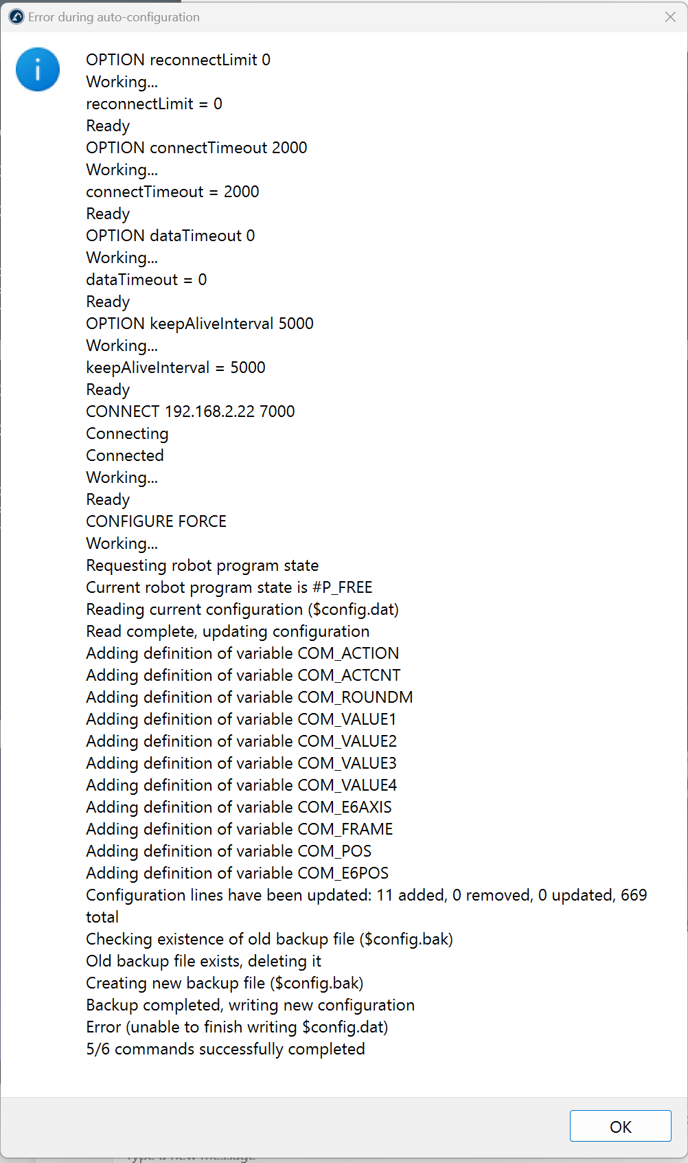

Hi there, currently getting an Error (unable to finish writing $config.dat) 5/6 commands successfully completed while running the KUKA Driver Auto Config script with RoboDK.
I have a KUKA KR6 R900
Running RoboDK v5.6.1.23473 (64 bit)
Controller: KR C4 Compact
If anyone could provide assistance I'd be appreciated, cheers.

Unfortunately, sometimes the control system refuses to overwrite this file without explanation.
We are working to ensure that automatic configuration is successful in 100% of cases.
In your case I suggest using the manual configuration: https://robodk.com/doc/en/Robots-KUKA-Ma...iverConfig

No worries, thanks Dmitry I'll give that a go cheers!
