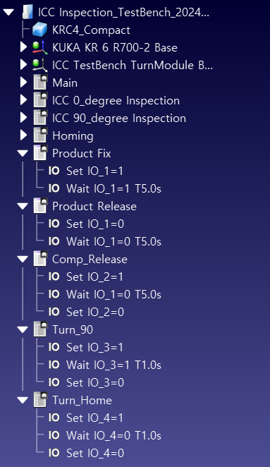

hello. I am currently working on a project using RoboDK and Kuka Robot's KRC4 controller.
However, although I am confident that I have studied a lot about RoboDK's various functions, I am having a lot of difficulties controlling the I/O of the robot controller with RoboDK's program.
When I use RoboDK as it is set at the beginning, I can see that IO_1 and IO_2 are properly outputting the digital output of the C4 controller, but IO_3 and IO_4 are not outputting. (As you can see in the attachment)
Currently, it is difficult to learn how to map the digital input/output of the robot controller with RoboDK because it is difficult to find an accurate manual or training video. I would appreciate it if you could provide a solution quickly.

Thank you RoboDK for your quick response.
I have solved the problem.
The cause was that I had connected another robot that I animated, not the Kuka robot, to a program that had 3 or 4 different I/Os.
I changed the robot in the program and the I/O is working properly.

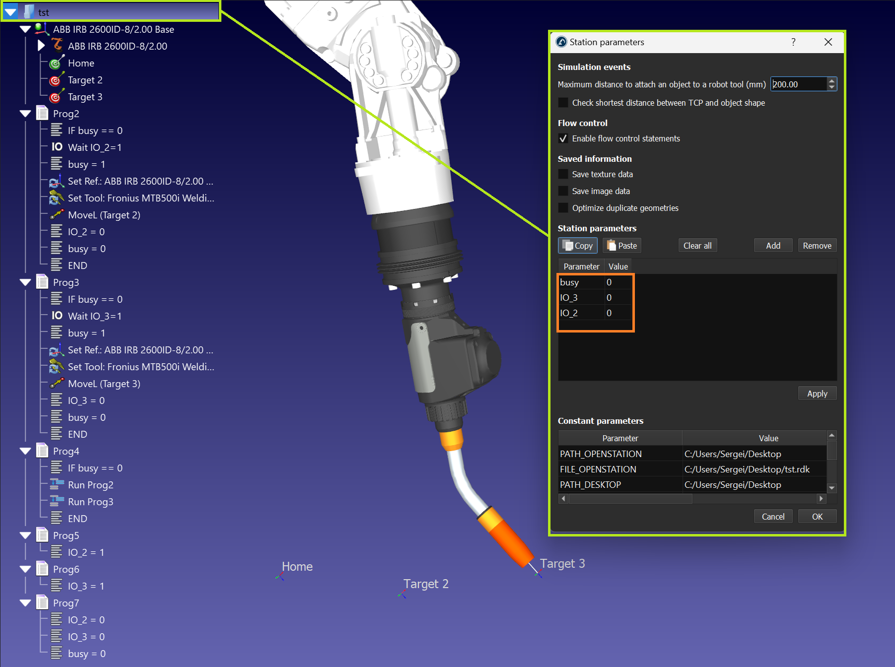

Currently, I am trying to control Digital Input/Output using Kuka C4 controller.
I want to read the digital input 4 bit from the parent controller, move to the target of that number, and echo the movement completion signal to the digital output. Can you give me an example of a flow control program in Python or command tree?
First, you can enable flow control statements by clicking on a station and selecting Station parameters - Enable flow control statements.
This will allow you to add custom variables such as state flags and implement state machine logic.
You can then assign various state-related actions to subroutines that will be called from the main program running in Loop mode (right-click on the program and select the Loop checkbox).
I attached an example station.
.rdk   pos_signal.rdk (Size: 1.54 MB / Downloads: 268)
