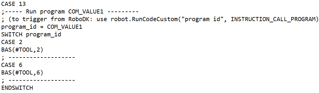

Dear Albert,
thank you very much for your reply!
I am not entirely sure if I understood you correctly, but I changed the RoboDKSync file as seen in the attachement.
With my python script I tried to run the "RunCodeCustom" command, but I am not sure how to pass the program ID so that the correct CASE within the Sync file is chosen.
According to your suggested thread I tried it like:
robot.RunCodeCustom("Program 2",INSTRUCTION_CALL_PROGRAM)
in order to enter CASE 2.
That does not work. So It seems like I am programming nonsense again.
Could you please help me with passing the program id, in order to choose the right CASE within the Sync file? Or to clear my misunderstandings?
Thank you very much!
Can you try calling RunInstruction instead of RunCodeCustom?
For example:
robot.RunInstruction("Program 2",INSTRUCTION_CALL_PROGRAM)
This should enter CASE2. Keep in mind this Switch case is inside another switch case.

To clear misunderstandings: You have mentioned in a different thread that I can not trigger programs by name, so "Program 2" is the fixed syntax? I do not have to adapt the "Program" ? Just the following integer, depending on what case to enter? My RoboDKSync file is the default file. Do I have to adapt anything else?
What do you mean by "this switch case is inside another switch case"? Do I have to set the according case (case 13 => COM_ACTION = 13) of the outer (first) switch case myself? In my understanding: The call of "RunInstruction(program_id, ...)" triggers (enters) the 13th case of the first switch case and with the program_id I choose the case of the second switch case. Isn't it like that?
