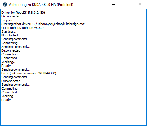

i did it. Now RoboDK has an error during the excution at the first program call.
The protocol is as an image in the attachmend
Actually you should switch to the legacy driver called apikuka (which uses the KUKAVARPROXY application on the KUKA robot controller) to make program calls work. We'll improve the official driver in the next 4 weeks to make program calls work.
