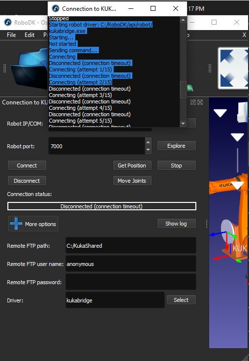

I have a Kuka KR 50 on port 7000.
I followed the C3 server setup on the KRC4 Controller and confirm the ip is able to be pinged.
On the client machine where I'm running RoboDK, I try connecting via IP and seems to never initiate the KUKAbridge. (Picture attached)
I tried to run KUKAbridge via cmd and received this message. "Cannot mix incompatible Qt library (5.15.10) with this library (5.15.1)"
I was developing a Qt application about a year ago, unrelated to RoboDK... is this something related to a system PATH issue?
Thanks!
I should mention, I have PATH set to C:\RoboDK\bin

I'm using v5.5.3.23034-Release date 2023-01-18 (64-bit) on Windows 10.
I was able to get KukaBridge to work on a fresh install of Windows, so I'm very suspect it's something in my environmental PATH with Qt
