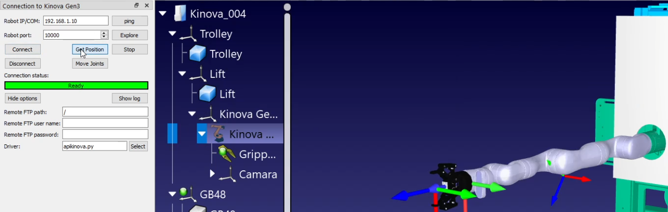

In the option Connect to robot, in addition to writing the Robot IP / COM: I had to open Hide options / Driver: Select / apikinova.py click OK,

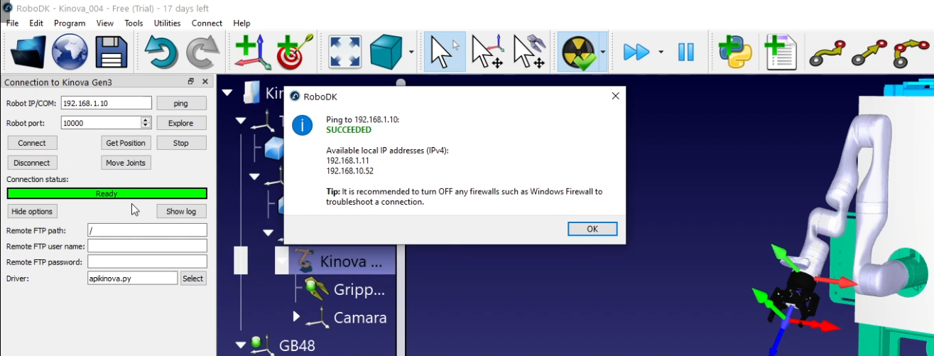

Check ping: everything seems correct,
Click Connect: Ready and green,

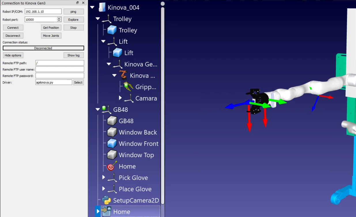

But I can't executing the programs in Run on robot, when I double click it disconnects and Get position in RoboDK the robot moves to a position that is not that of the real robot.
Curiously, RoboDK says that it is connected to the robot without being connected by clicking Connect, you can check it in the file in the download link
