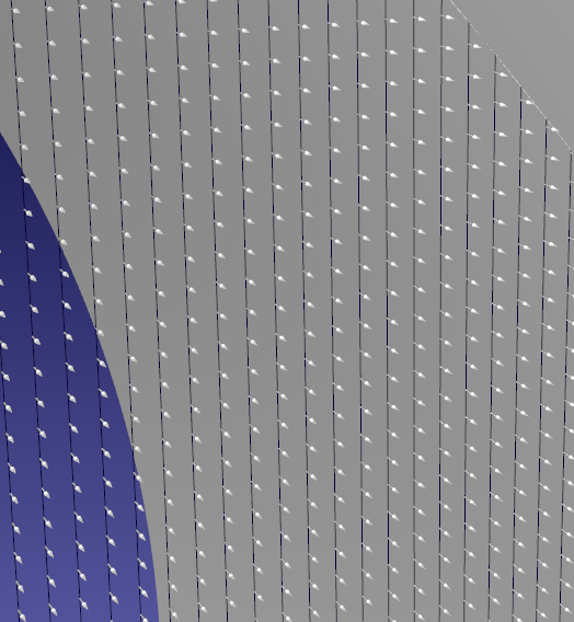

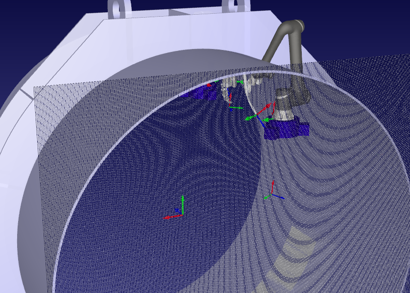

I just created a giant tube(D=3400mm) and loaded it in RoboDK.
But when I selected the part, plenty of arrows were shown and this dramatically slowed the speed of view-changing with mouse. Is there any tip to resolve this?

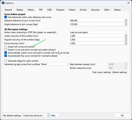

It seems like the plane was imported as a curve. Make sure you have this setting disabled before importing:
You can reach this menu by going into:
Tools ⮕Options in the CAD tab.
Alternatively you can split the object and delete the curves manually.
Feel free to attach your station and I can help you with it.

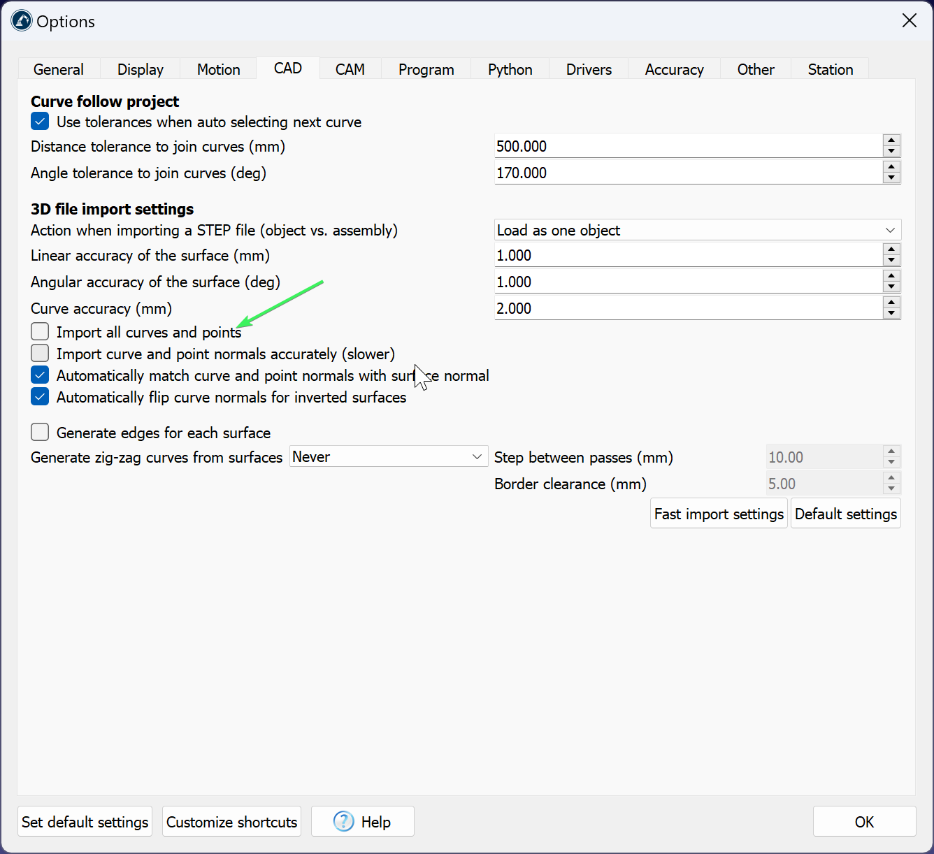

Thank you for your reply.
I have disabled the setting and reload it agian, but nothing helps.
Instead, I could delete the plane as you recommanded with "right click -> split object " function.
The station is also attached in case you want to investigate it.
Anyway, the problem is resolved. Thank you again :)
