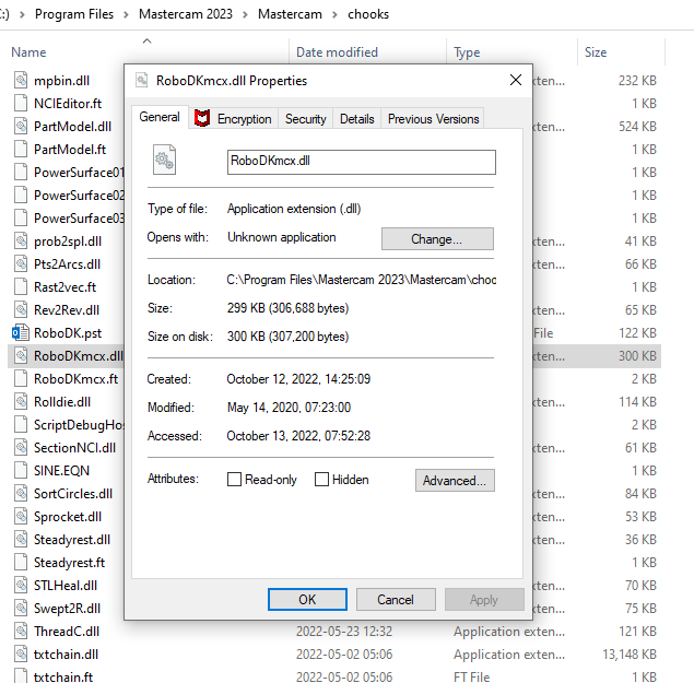

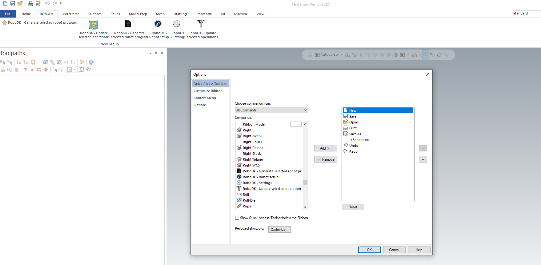

Hi Albert,
I can confirm that the DLL settings are the same as Mastercam 2022 and they show up when adding to the ribbon (See photo). I don't have the unblock option when in the properties menu I am guessing then it would be already unblocked?
Thanks,
AL
