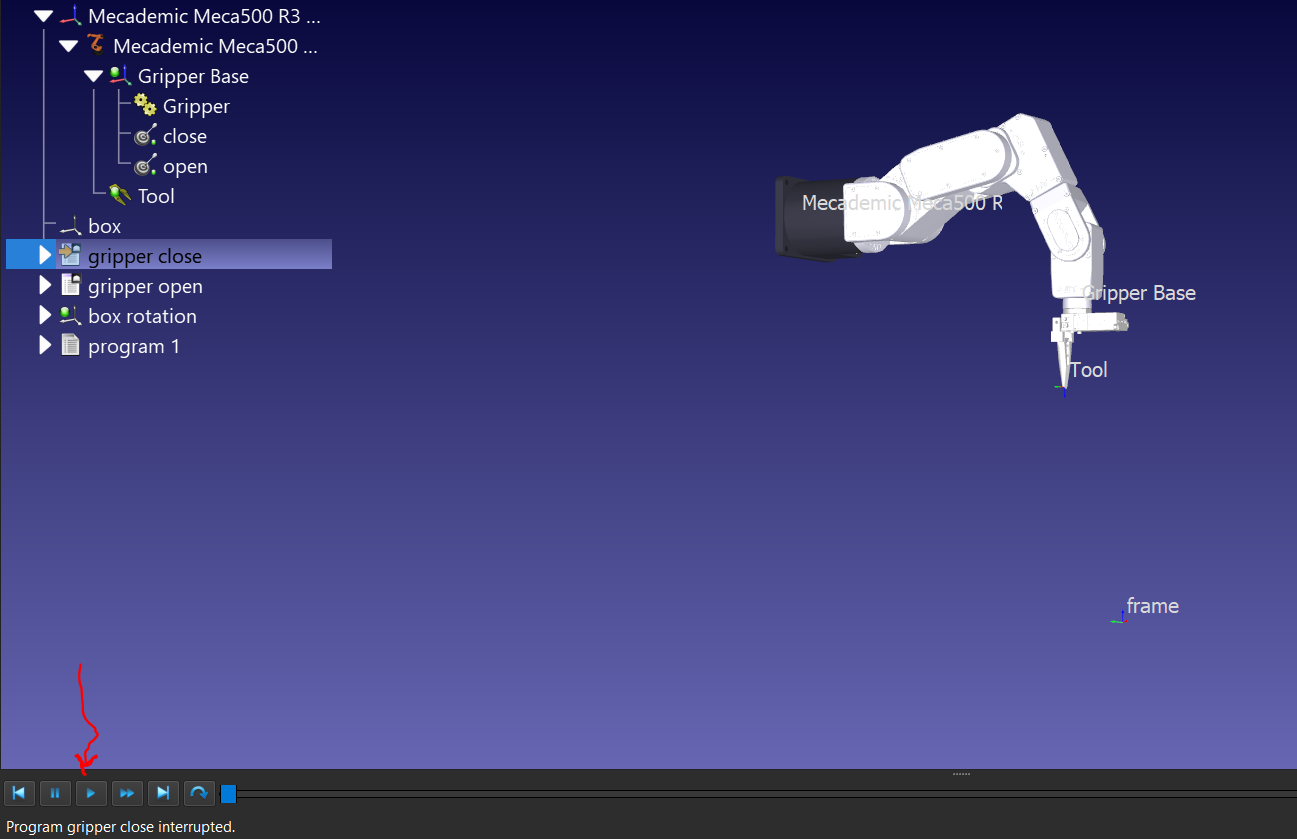

The Mecademic Meca500 is attached to Meca 25E gripper and programmed in robodk. Without robot connection, the gripper opens and close in Robodk simulation but when the robot is connected, the program stops at the gripper close-open function does not work (For gripper, a Mecademic post-processor is already selected). Can you please help me with this?

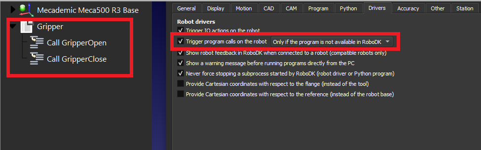

To control the Mecademic gripper from the driver, download the latest version of RoboDK first.
Then go in the Tools-Options->Drivers and make sure "Trigger program calls on the robot" is activated.
In your main program, call a empty program called either OpenGripper or CloseGripper.
Let me know if this solution still doesn't fix the issue.

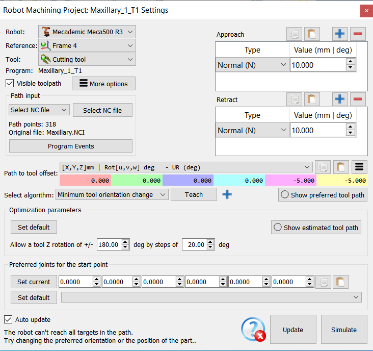

Also, I found another issue, In my current setup, I used the curve follow feature for following the robot on a curve. The robot reaches all the targets and also moves on the created path during simulation perfectly, But many times, on the same setup and on the same .Robodk file created, when opened again after saving, it shows robot can't reach all the targets in the path. I need to reinstall the .Robodk Software everytime, I had this problem. I couldn't find the problem(setting) causing this. Can you please help me with it?
Next time you get this issue, could you provide your .rdk file?
Sure. Can you please check and let me know. The file attached shows that the path is perfect and the robot runs perfectly but sometimes, robot can't even reach the targets
.rdk   actual setup.rdk (Size: 3.79 MB / Downloads: 765)
