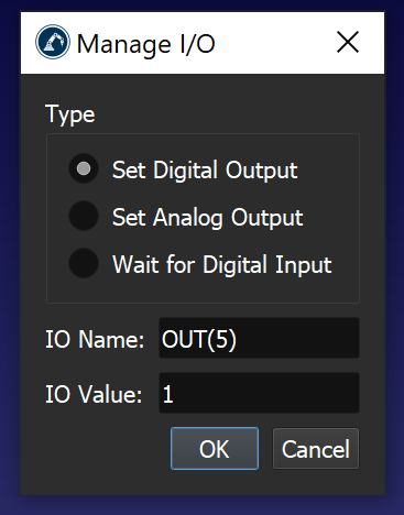

As you mentioned, RoboDK outputs M_OUT by default for digital outputs. If you want to change this behavior, you can manually enter your string.
For example, if you use the UI and you want to output OUT(5)=1 instead (no "M"), you could set the digital output instruction like this:
Also, if you are using the C# API you could also do:
robot.setDO(5,1)
This will output the following code by default:
M_OUT(5)=1
However, you could also do:
robot.setDO("Out(5)", 1)
Which will output:
OUT(15)=1
You can also change the default behavior in the post processor by changing the variable DOUT_STRING.
