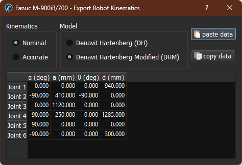

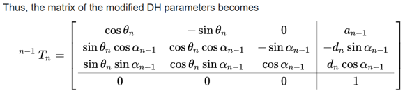

Hi, I am trying to make a forward kinematic solver using the DH parameters from RoboDK. I was able to get the modified DH parameters from the robot's parameters, and I tried using the transformation matrices from Wikipedia for the modified DH parameters to solve for the transformation from the base to the flange, but I cannot get my solver to match RoboDK, and I'm not sure why. Shouldn't I be able to pair the parameters with the transformation matrices attached to get a working solver?
To provide more information, I solve the transformation between each joint using the transformation matrix in the image attached, then I multiply the transformation matrices for each joint to get from the base to the flange. I don't have any additional tools on the robot, so I don't have any additional transformations to get to the TCP.

You should be able to match the data by using the dhm function in the RoboDK API.
Calling dhm(rx,tx,tz,rz) is the same as using rotx(rx)*transl(tx,0,tz)*rotz(rz).
https://robodk.com/doc/en/PythonAPI/robo...bomath.dhm
How are you implementing the math?

I am calculating the transformation between each joint using the modified DH transformation matrix I attached originally. Once I have the matrix for the transformation between each joint, I multiply them in the order shown in the new attachment to get the transformation from the base to the flange. I have double checked that I am using the correct transformation matrix multiple times, and it is definitely the modified version. I am trying to solve it without any tools on the robot first, so I am not doing any additional transformations beyond the flange.
