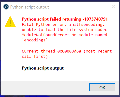

Motoman Error importing ALL.PRM
I have yaskawa GP25-12.
I use the embeded python
I have the latest robodk 5.6.9
I have ALL.PRM from the robot.
I have tried it on my actual station file and made a new one which I add here. Does not import the file on both of my computers.
Module encodings are missing.

Can you send us a print screen of the error?
of course, here you go
I updated your station (attached) with the .prm file you shared
.rdk   gp25-12_md.rdk (Size: 1.07 MB / Downloads: 675)
Thanks Sergei. Works now :D
