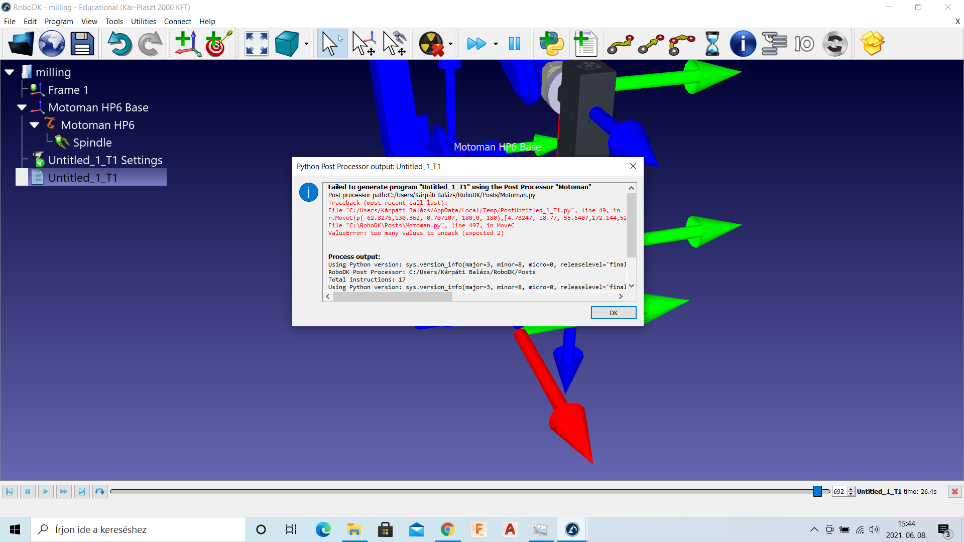

I bought the student license today and when I send a shit track from the fusion 360 program to the robodk it also shows up but when I want to generate a program from it that I can then use on the robot then I can't generate a program.
I will also send the program and the error message.
Thank you in advance for your reply.
.rdk   milling.rdk (Size: 1.59 MB / Downloads: 748)
You should update RoboDK to the latest version.
Let us know if the problem persists. If the problem persists we would need a print screen of the settings you have in Tools-Options-Program tab.
