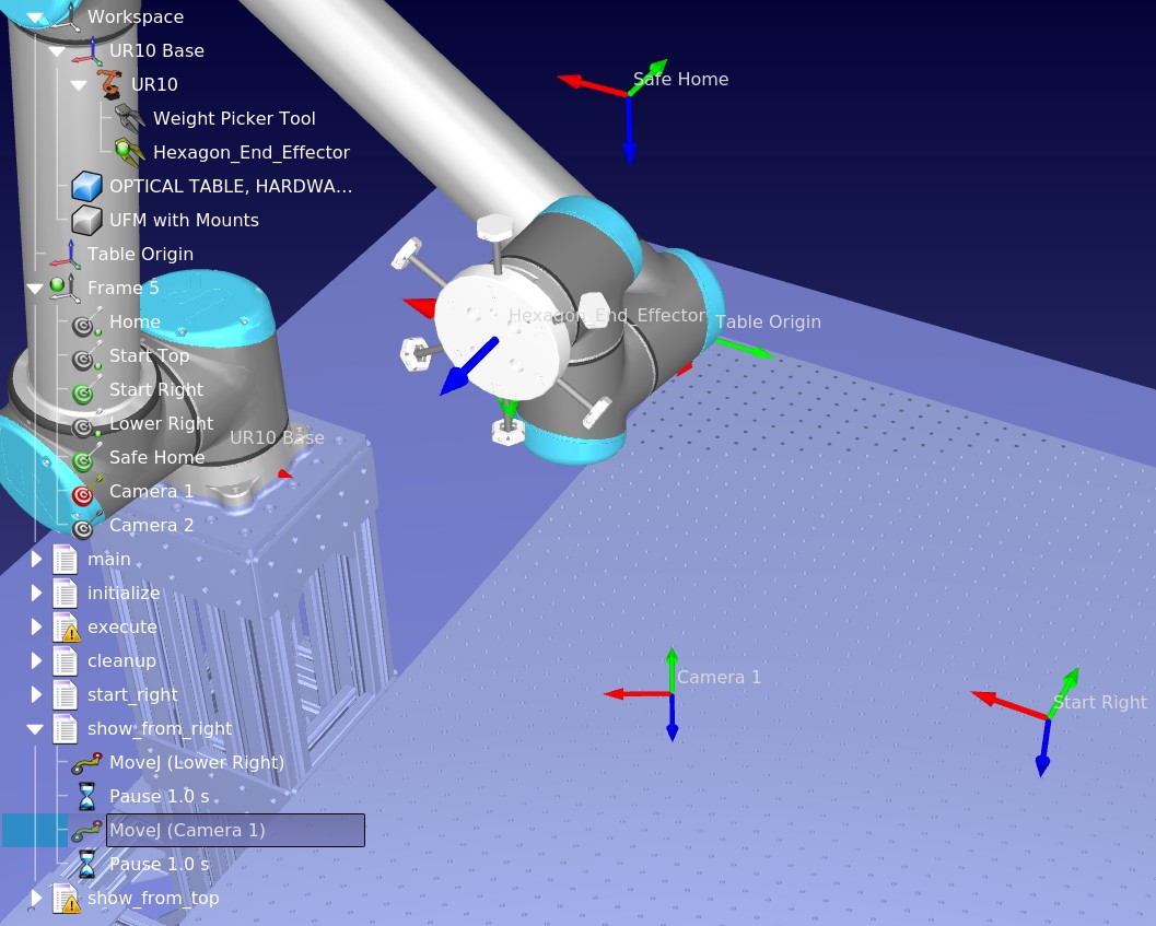

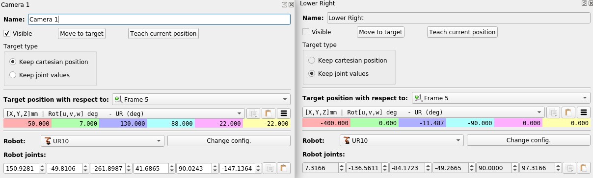

Hi, I'm programming a UR10 to repeatedly move back and forth between targets A and B with a hexagon-shaped "tool" that has a picture on each of it's 6 sides. At target B there is a camera which will look at the picture. Every N cycles I want to rotate the tool to a different picture while it is at target A (out of the camera's view). After rotating the tool the robot repeats the cycle with the new picture.
The problem I am having is the tool always rotates to the desired image WHILE it moves to target B and rotates back to the first image WHILE it returns to target A.
