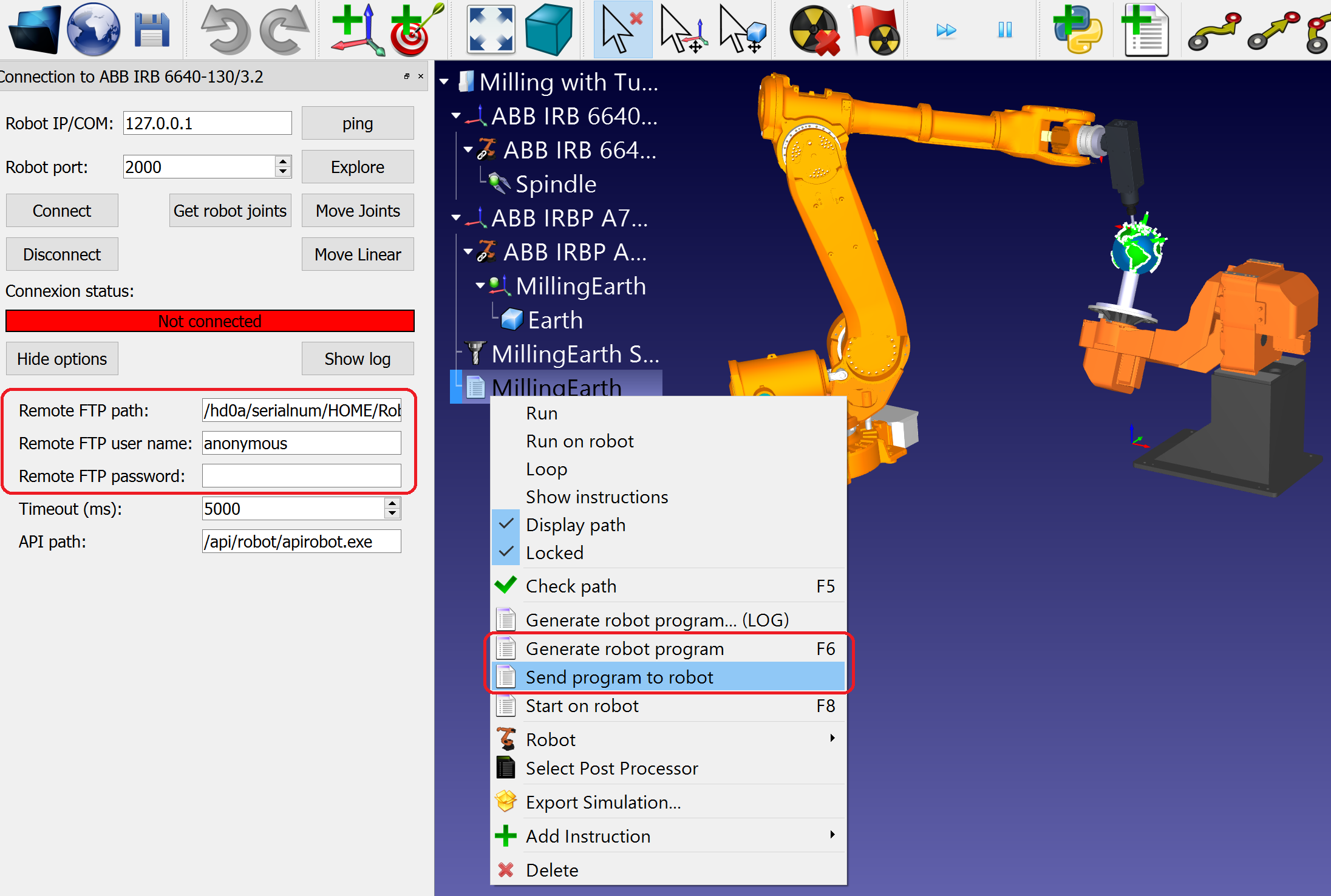

With the newest version you can also transfer files automatically through FTP or other protocols:
1- Right click a program
2- Select: Send program to robot
The FTP parameters from the robot connection menu will be used to run the following post processor method once the program has been generated:
    def ProgSendRobot(self, robot_ip, remote_path, ftp_user, ftp_pass)
For ABB robots you can then use ABB RAPID's Load method to load modules that have been transferred through FTP.
