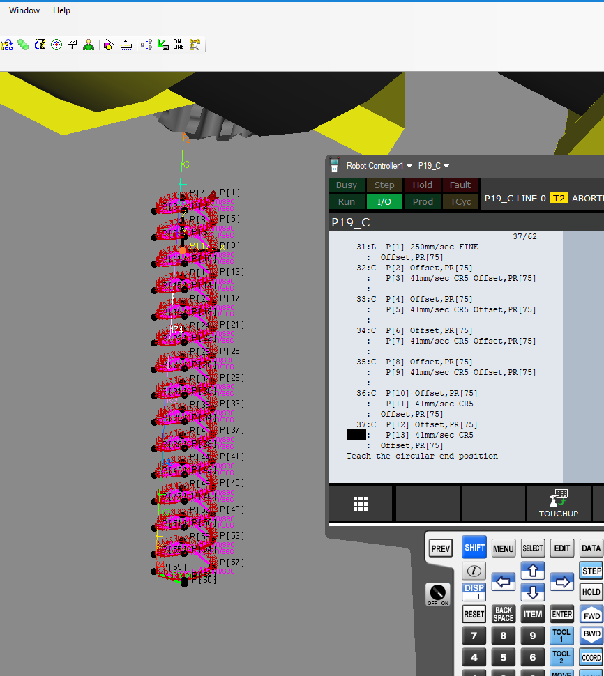

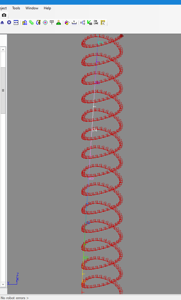

I would like to know if, for my case, it is impossible to have circular movements.
Posts: 4,847
Threads: 2
Joined: Apr 2018
Reputation:
226
No, it is not possible to convert spiral movements to circular movements.
You should change the drilling approach to not use spiral movements.

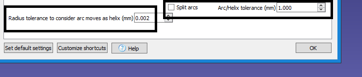

The radius tolerance to consider arc moves as helix allow you to control the tolerance to convert helix to arc movements.
You can increase this tolerance to generate an arc instead of an helix, however, I strongly recommend to keep this tolerance small if you want to keep path accuracy.
The split arcs tolerance will convert arcs into smaller linear movements.

I insist that a spiral movement is not the same as an arc movement.
