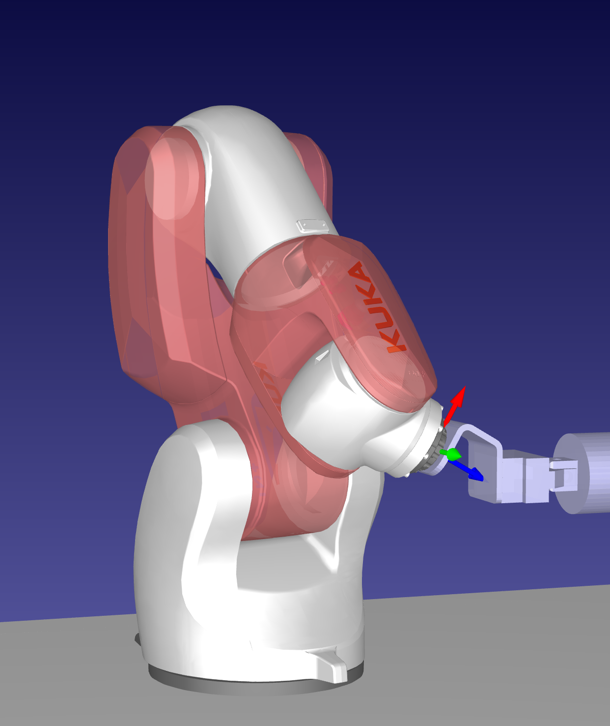

I have written a python script to analyse the workspace of my robot and if a specific set of moves is possible.
In the relevant section of the script I first check if a linear movement is possible with MoveL_Test. If there are no issues MoveL is executed.
Occasionally (in some poses) it raises this error:
I did not touch the script or the robot.
I suspect the reason is that the robot collides with itself (see picture below, it shows the position of the robot after the script stopped). Which seems strange to me, since the robot only executes MoveL, when MoveL_Test raises no issues. So the movement should be free of collisions.
Collision checking is on. (RDK.setCollisionActive(True))
