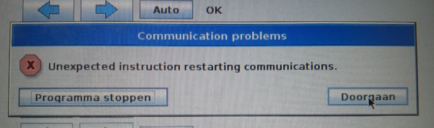

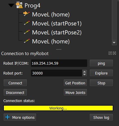

Hallo,
When using a program using moveL (see image 1) it is stuck on waiting and the UR10 does not move.
The display of the UR10 shows the following error message seen in image 2.
Pressing either "Programma Stoppen" (Stop Program) or "Doorgaan"(Continue) will disconnect the UR10 from my pc.
I hope this clarifies the issue.
