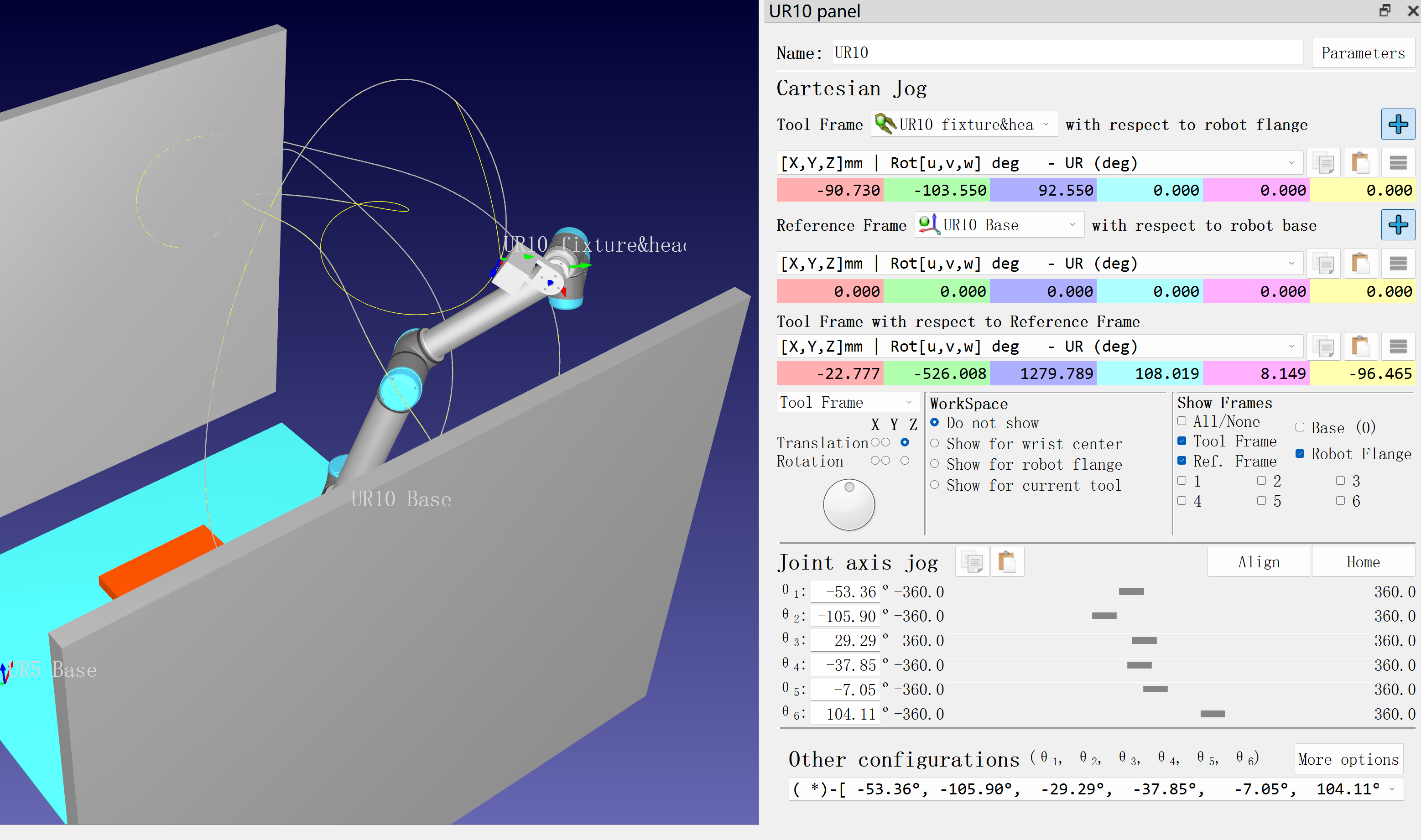

I have a trajectory about UR10 robot,and it's successful to run whole traj by moveJ, but when use MoveL to control, it went to wrong with 'robodk.robolink.TargetReachError', seems like 'Unable to reach desired target or destination error.' I checked all my programs and robodk sets, still not find any mistakes. The code block is here:
I would like to ask about some questions about MoveL control in RoboDK.
