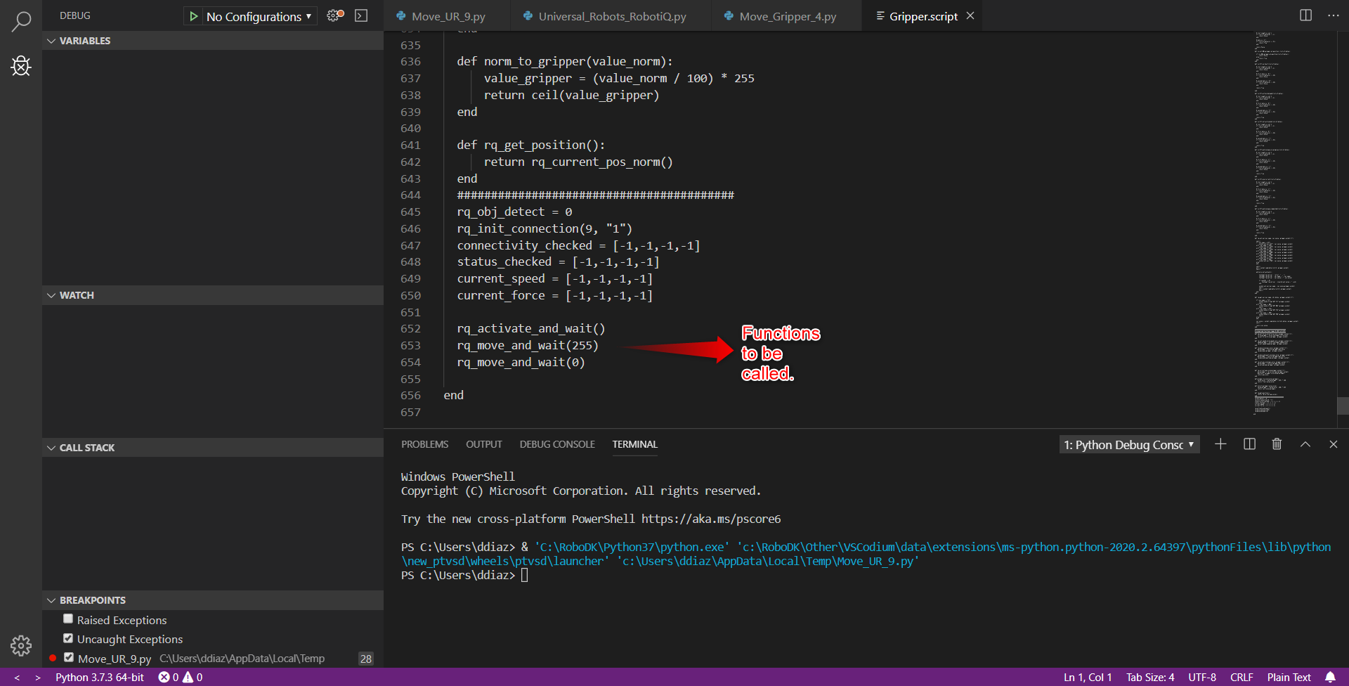

Hi Albert,
I'm attaching the script code that I used in order to make the robotiq gripper work adequately! The last three lines of code (I_1) belong to the functions I want to be called.
The current header of the script in the post-processor (Universal_Robots_RobotiQ) doesn't work properly.
Daniel.
.txt   gripper.txt (Size: 15.5 KB / Downloads: 1,193)
