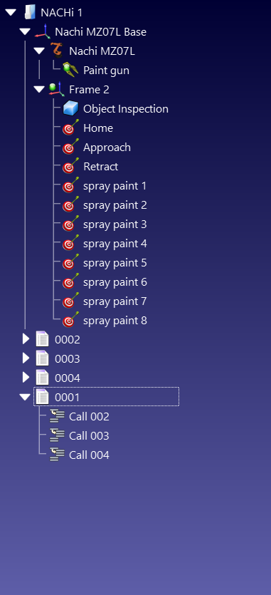

Hi, @Omoikane.
I'm not a NACHI specialist, but if I recall correctly, NACHI robots require a very strict program naming convention, and they must be the robot model, suceeded by a three or four digit  number. So, In your case, You would have MZ07L-A.0001, MZ07L-A.0002 and so on.
But inside the robot, You can see only the number itself.
I've did a small test here, and renamed the programs, and have this results.
I don't have a robot to try the upload, but I think You must play with the program names to be allowed to upload the program in the robot.
I forgot to mention that NACHI programs in ASCII format have an A appended on its names, so the programs must be named MZ07L-A.0001, MZ07L-A.0002 and so on
Hi massula,
You got it. So after reading your post and dig a little deeper into the robot language, command call, program naming convention, and program numbering, there's a bit of manual name changing in RoboDK to make *.xxx number correctly, and then the main program can call the subprogram.
You help me solved, like, 4 pieces of the puzzle. : )
Thanks!
Nice to know, Omoikane.
