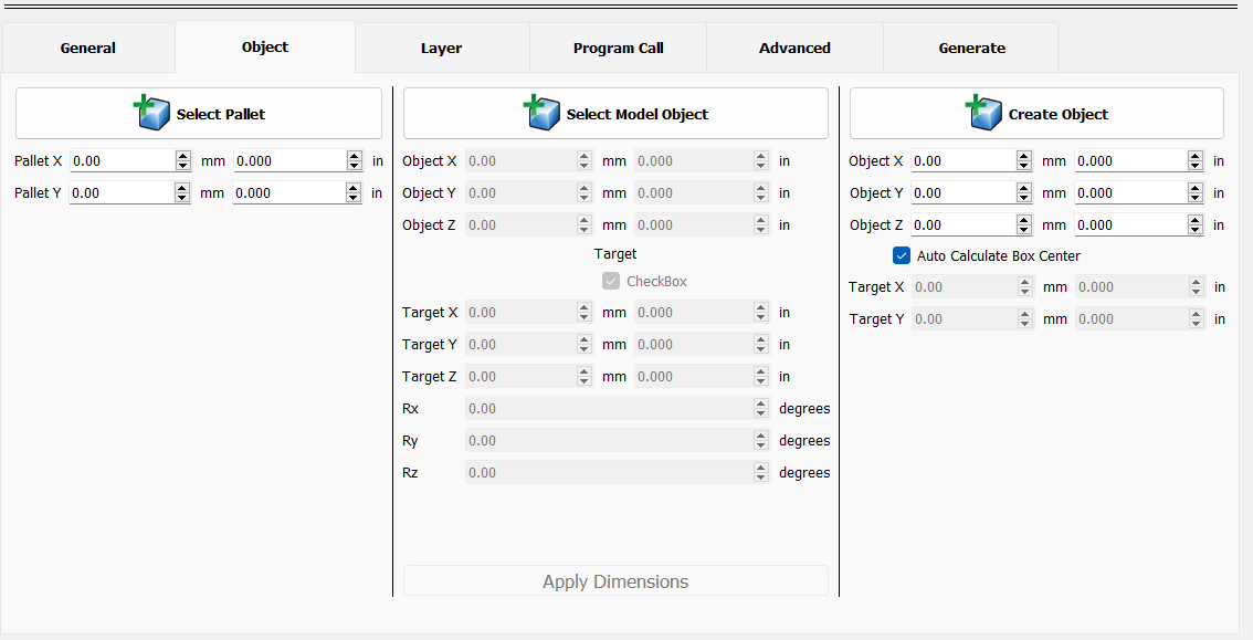

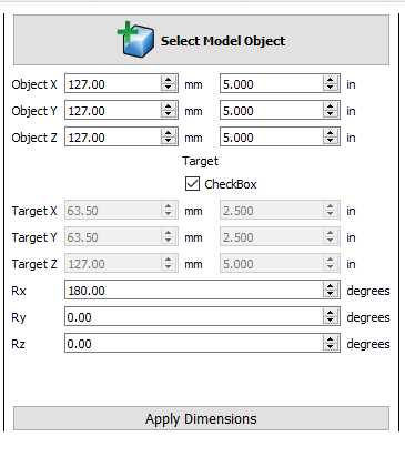

Yeah, not ideal behavior having the targets Z point up by default, as a temporary measure, you can select the spawner object on the left, navigate to the Object tab in the palletizing editor and apply a 180 degree rotation on Rx or Rz to correct the issue.
Hi, where exactly can I find the spawner object? I tried to use Box Spawner, but it doesn't seem to be what you are saying.
You can try using the Box Spawner Add-in:
https://robodk.com/addin/com.robodk.app.boxspawner
This addin allows you to programmatically add box objects in your RoboDK Station.
